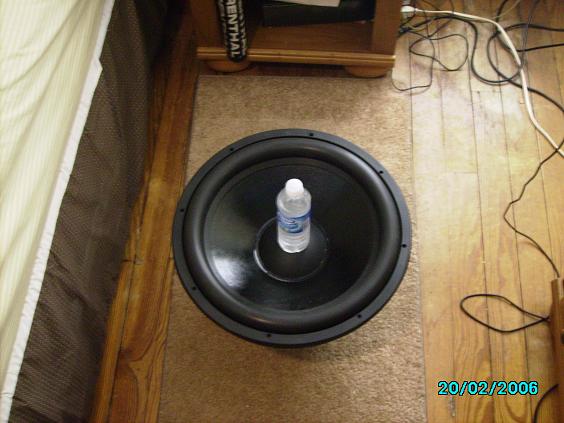

18 inches of RE/FI woofa !
Username: Jblanford
Post Number: 1283
My 18" mt is here ! my other mt motor comes tomorrow along with another Fi recone kit. These will be walled off in my 99 jeep gc and powered by 1 Stetsom V7kd (7000rms) 200 A alt and 2 NSB 90 batteries...
Will have pics when i start with the build.
