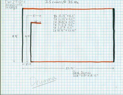

Silver Member Username: Joebruce15 Inch Wang... Post Number: 957 Registered: May-04 | Well i cant cut it myself b/c i dont have the tools to do it. Maybe ill go to Lowes lol. Still if i can get everything for 50 or less i wont be to upset if i mess it up. Itll be a learning experience for me. What do you think of this design? http://www.subwoofertools.com/forum/ported-box.asp?Ew=42&Eh=24&Dia=9&Xmax=21&Vd= .18&NumW=1&Vb=3.5&Fb=36&Qts=&Vas=&Fs=&CE=0 I dont know the xmax or disp. of my sub so i kinda guessed. |
Bronze Member Username: DrummaIndianapolis, IN USA Post Number: 41 Registered: Jun-07 | Lol yikes. I could do one fore you for $110 shipped [non carpeted] And I would put your priority over the one I was gonna build tomorrow. I've got the tools here and experience, and I can assure you that you will not be dissatisfied. I can get it built for you tomorrow, and shipped out monday if you are interested. I just bought a sheet of MDF yesterday because I was planning on building that single 10" enclosure, but I can do this one for you instead. |
Silver Member Username: Joebruce15 Inch Wang... Post Number: 958 Registered: May-04 | Thanks but i think im just gonna try it myself. Do you think that design above will work? Or could you maybe design one for me? |
Bronze Member Username: DrummaIndianapolis, IN USA Post Number: 44 Registered: Jun-07 | Ok, I just made a design for 3.5 cubes @ 35 Hz. |
Bronze Member Username: DrummaIndianapolis, IN USA Post Number: 47 Registered: Jun-07 | TWiZTiD Here is a blueprint for 3.5 Cubes @ 35Hz I hope this works for ya. ![]() |
Bronze Member Username: DrummaIndianapolis, IN USA Post Number: 48 Registered: Jun-07 | Sry, im sloppy without a straight edge =/ |
Bronze Member Username: DrummaIndianapolis, IN USA Post Number: 50 Registered: Jun-07 | If you have a hard time seeing it, I can send you a bigger version of this via email. Let me know what you think. |
