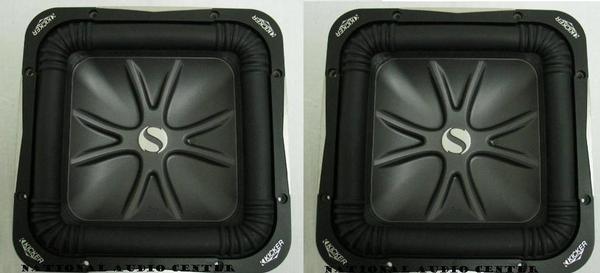

How do I wire a 2 2 Ohm DVC 15" L7's to 4 ohm load to mmy amp
Username: Chris1029
Registered: Apr-07

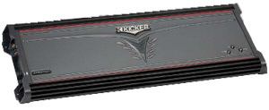

How do I wire my 15" L7's that are 2 ohm to run to my amp at a 4ohm load. I kind of don't want my amp to push alot of power to them because they don't make a HO alt for my van (2004 Honda Odyssey). I've checked Ohio Generators and everyone. Anyways someone told me that if I wire my subs to 4 ohm, it will make my amp push less watts. How do I do that and what are any suggestions on what I can do so I wont kill my alt. and battery? I have a Kicker 2006 zx2500 amp. My alt. is a stock 130A and is rated at 170A according to Ohio Generators.Please give me any input you can if you know what your talking about, it will be greatly appreciated!!

Chris, well with those subs (Dual 2ohms) you cant wire it to 4ohm total.. wire it to 2 ohms and just watch your power level while setting gain.. but if you got that amp..... its such a waste to not turn the gain up ;)
