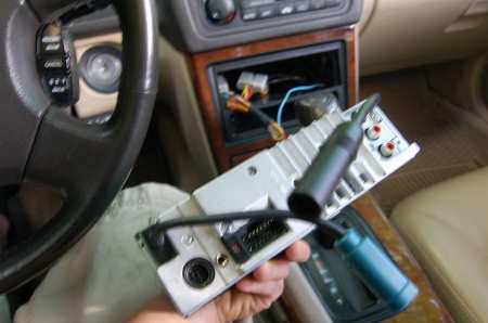

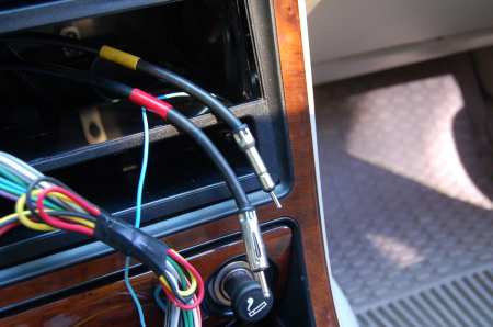

What do these two cords do and where do i plug them in to? I dont have an ipod btw and dont need a plug in for it.
Where do I put the remote wire? My new HU came with a new wiring thing or harness that i plugged into the back, but i already have 2 other wiring harnesses in that empty hole

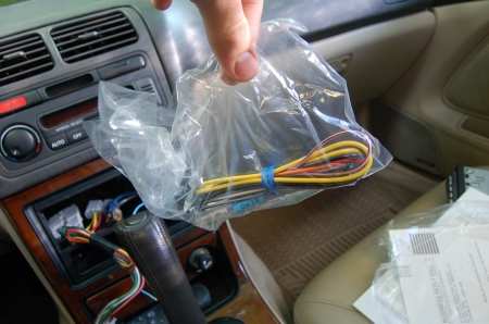

Theres the wiring harness from my old HU, but it wont fit on my new HU.. no worries there is a new harness with my new HU, but I dont know how to hook it up.
This is what came with the new HU, i hooked it into my new alpine but all the wires need to be stripped and crimped somewhere, but idk where.

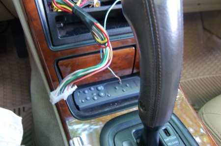

This is just the inside of the hole where there are 2 harnesses and none of them even work for me, should i take them out somehow or what? How do i hook the remote wire?

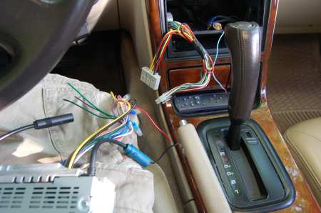

My RCA's... one is blue one is white, and there are 3 places to put 3 different sets of RCA's there, should I use the top one and blue in the red and white in the white?

The 4th picture down is my old eclipse HU, not the alpine one... the pix messed up, so paragraph 1 = pix 1, paragraph 2 = pix 2 and so forth. Thanks for help. I have a shitload of HW, so i may be slow responding. Thanks for ur guys help.

My stock harness is connected to another harness, which hooked into my eclipse, i pulled my eclipse out and there is the harness that the eclipse hooked to and alpine sent me a harness to fit that certain cd player, and the ends of the wires still need to be split and spliced in, they didnt send me a double ended harness. Look at the last picture and the Hu sitting on my lap, see how the wires are just lying loosely and need to be spliced into something?

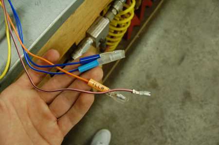

Sh!t i cut the yellow red and black wires, but re soldered them to the alpine wiring harness. Is this ok? I wired every wire that had a match from the alpine harness to the regular harness..
There were 2 wires... An orange one with a white stripe, and a light blue one (same color as my remote wire) that didnt have a match (on the regular harness). And from the alpine harness there was a pink w/ black stripes, 2 blue ones (one with white stripe), and a plain orange one. What do I do with these?
My remote wire that is in my car is light blue too, should I solder that one to the lightblue one on the factory harness or where do i put my remote wire?
Also, Which one of those big plug ins do I plug into the cd player? The one with the Red or Yellow band? What are they for and do i need both?
