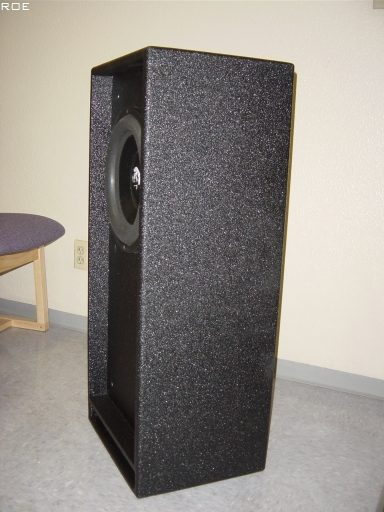

Silver Member Username: Volfenhagking160015 SSD Wangin, Shawano, Wis... USA Post Number: 671 Registered: Oct-06 | What are the pros and cons of using this stuff on my box? I heard of it awhile back and was wondering if it would be safe to use something like this for my box? |
Gold Member Username: MgbcsLincoln, Nebraska Post Number: 1193 Registered: Dec-06 | That's exactly what I want to do. I think it would be bad a**... |
Silver Member Username: OneracistguyTWO EGG, FL USA Post Number: 665 Registered: Sep-06 | ive seen it on boxes that are in places that leak it works nice |
Gold Member Username: MgbcsLincoln, Nebraska Post Number: 1195 Registered: Dec-06 | I don't know about Jamie, but mine wouldn't be for funtional purpose. I just think it would sweet. |
Silver Member Username: Volfenhagking160015 SSD Wangin, Shawano, Wis... USA Post Number: 672 Registered: Oct-06 | well i was just wondering i thought it would be awesome too ![]() |

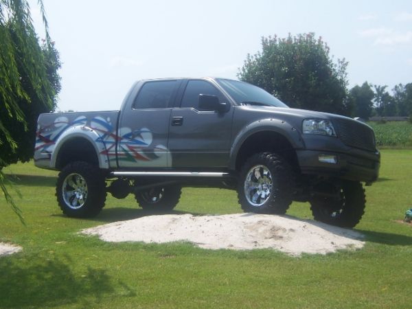

Gold Member Username: ShortysetniesRock Vegas, NC US Post Number: 1262 Registered: Mar-06 | my bud did that in the bed of his F-150 and it turned out nice and works great... He had it rhino lined along with the truck bed so it was done professionally. Truck: Box: ![]() |
Silver Member Username: OneracistguyTWO EGG, FL USA Post Number: 676 Registered: Sep-06 | whats so great about that truck being on a lump of sand? |
Gold Member Username: ShortysetniesRock Vegas, NC US Post Number: 1266 Registered: Mar-06 | he was just takin the pic at his house. its all for show, he doesnt take it off road either so thats probably the most "flex" that list is gonna see |

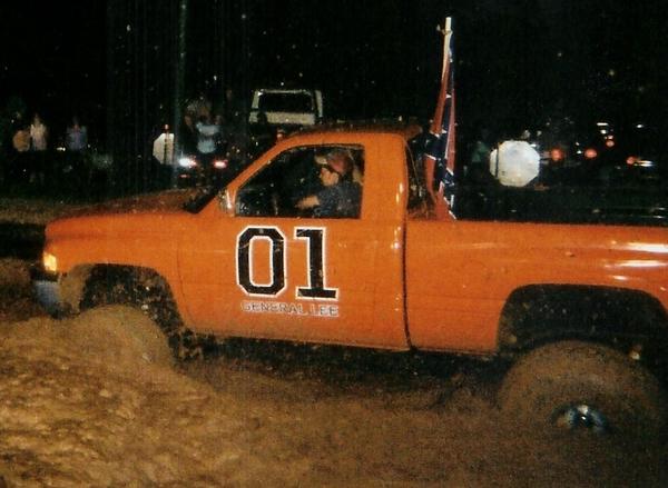

Silver Member Username: OneracistguyTWO EGG, FL USA Post Number: 679 Registered: Sep-06 | just cuz they are offroad doesnt mean that they look like sh1t only the hardcore offroaders dont care about looks cuz they do too much to mess up the looks heres a local truck that looks pretty good for someone whose 18 it goes to the bogg in all the time ![]() |

Gold Member Username: Tdeaton1021Near Tampa, Florida USA Post Number: 4236 Registered: Sep-04 | that f150 looks 100 times better than the ram. JMHO |
Silver Member Username: OneracistguyTWO EGG, FL USA Post Number: 682 Registered: Sep-06 | didnt say it look alot better but its a nice lookin truck that someone actually uses whats the use in putting a lift and tires on a vehicle if all its going to do is kill ur gas milage and not give u any entertainment |
Silver Member Username: NorthomahaPost Number: 336 Registered: Mar-06 | yea, F150>Ram. thats cool how he exposed some of the box in the truck bed. Im thinkin about doing this to cover a box i made. Its cheaper than shipping carpet. |
Gold Member Username: ShortysetniesRock Vegas, NC US Post Number: 1268 Registered: Mar-06 | Yeah he built it STRICTLY for shows. The dash is completely fiberglassed, all new interior, obviously the paint, shaved tail lights (tails are in the roll pan), roll pan for the bumper, rear doors shaved, rear tail gate handle shaved, 2 15" Rockford p2's (I think they are the P2's) sittin up 8", 36" tires and 20" rims. He has a yota for a daily driver that is stock... |

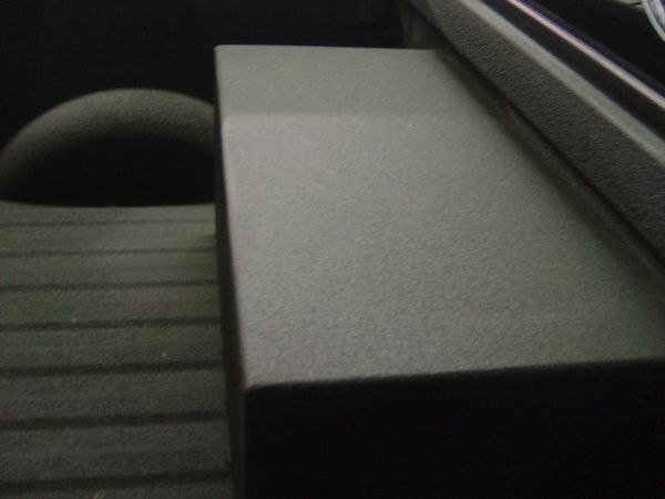

Silver Member Username: CcdoggyPost Number: 116 Registered: Jul-06 | TIPS on applying what i refer to as "The black Death". I used the duplicolor stuff fron the auto parts store, the big jug of it and 2 cans for finishing effect. Why its called the black death is it's 5 main ingredients cause cancer and it does not clean up with anything. Multiple layers using the special roller. the roller is the only thin i can think of that gives it that textured look. Do it in temps above 70, really they mean it. anything under that and it tacks up too quickly and starts to gobb up. Use the can stuff as a finishing texturizer. Make sure you have a place it can air for a few days. It take a long time to fully cure ~3-4 days, and smells for about a week. I had a few times i was going to faint from the smell of the stuff. It is Vinyl based, nothing that i found cleans it out or off of anything. paint thiner does nothing, same with water. to hide the screws (if you are motivated) use a wood filler, once dry sand it down and it will dissapear with a coat of the black stuff. Dont put any in the port, it will only create resistance and cause the air to make high pitched noises as its sucked in and out of the port. you want the port as smooth as you can get it. Here is my box. Its a FI Q 15" in a 12 CuFt box for my home theater, Tuned to 14Hz. http://img255.imageshack.us/img255/4772/cimg0912gz6.jpg |

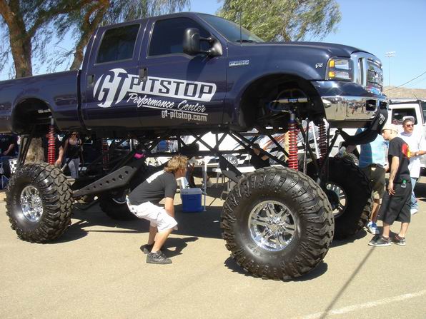

Gold Member Username: Th3pwn3rPost Number:... Post Number: 2372 Registered: Jul-06 | "didnt say it look alot better but its a nice lookin truck that someone actually uses whats the use in putting a lift and tires on a vehicle if all its going to do is kill ur gas milage and not give u any entertainment" J B do you have any idea what show cars are?It's not meant for daily driving but made for showing off.You don't abuse show trucks/cars,it would just be stupid and defeat it's purpose.Oh and a lot of guys out there jump out of their huge trucks and are like 5 feet tall,talk about compensating,it's pretty funny if you ask me. |

Silver Member Username: BudlingCali USofA Post Number: 325 Registered: May-06 | I really like the texture on these, I wonder what kind of liner they used? ![]() |
Gold Member Username: MgbcsLincoln, Nebraska Post Number: 1216 Registered: Dec-06 | I'm pretty sure it's the same stuff everyone is talking about. It looks the same as the stuff I have used in the past, I guess a little thicker tho... |
Platinum Member Username: BestmankindLos Angeles, CA USA Post Number: 12548 Registered: Oct-05 | lol naw ben its all good. you are too cool to ruin anything. lol. woofercooker......that is the exact look i want for my box. what the hell is that stuff? i don't think that came out of a can though. |
Gold Member Username: MgbcsLincoln, Nebraska Post Number: 1217 Registered: Dec-06 | The stuff in the can is a little different. It has a lot of texture, but it is smaller textures. I don't know if that explains it right tho. The ones in those pics is a different texture...almost rubbery. The spray can is a lot like really coarse sand paper when dried. (Sorry for the rambling, I got to the point eventually) |
Silver Member Username: BudlingCali USofA Post Number: 327 Registered: May-06 | Ben, thats stuff looks alot more textured than the stuff SteveH used^^^^ |
Gold Member Username: MgbcsLincoln, Nebraska Post Number: 1218 Registered: Dec-06 | Yeah I understand. Describing texture on the net FTL! |

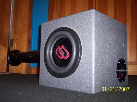

Silver Member Username: Wolf_houndPost Number: 189 Registered: Sep-05 | i like the texture on this one its called fleck stone they sell it at walmart.![]() |
Gold Member Username: MgbcsLincoln, Nebraska Post Number: 1220 Registered: Dec-06 | That is pretty nice looking. Not as bad a** as the black, but it's kinda classy. |
Silver Member Username: NorthomahaPost Number: 339 Registered: Mar-06 | do you know if they have that in black? |
Gold Member Username: Safe_crackerChicago, IL US Post Number: 2745 Registered: Jan-06 | They have it in all kinds of colors! We use to fleck our dashes back in the late 80's when it first came out..Polo. ![]() |
Silver Member Username: CcdoggyPost Number: 119 Registered: Jul-06 | The stuff I used was roll on and spray. I dident have a sprayer that could handle the stuff. it needs a like 1/4" sprayer. I would imaging spraying it would get smaller bumps and texture but still some there for effect. |
