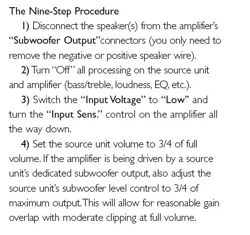

Los Angeles, CA USA
Post Number: 12441
well according to my jl 1000/1 manual, your volume should be at 3/4 and also the bass volume should be at 3/4. after you set the gain you would put it back to 0 of course.
Username: Nd4spd18
Southeast PA
Post Number: 2018
No offense chad but are you sure you read that right. JLs online gain tutorial spells out exactly the right way to set gain, and thats not in it:
http://mobile.jlaudio.com/support_pages.php?page_id=143
Los Angeles, CA USA
Post Number: 12444
i see what you are saying M.S. but if you read the manual, it tells you if you have volume for bass also you should set it to 3/4 on that too.
Los Angeles, CA USA
Post Number: 12445
this is from the 1000/1 manual.
Username: Nd4spd18
Southeast PA
Post Number: 2020
Alright well, I wouldn't want my amp to clip ever so I would have it all the way up when setting gain.
