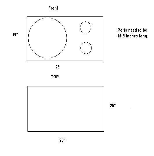

Here ya go. This should be 3 cuft tuned to 35 hz. The ports are 2 4 inch flared ports.

aright so i go to homedepot and tell them i need 2 4 inch flared pipes, 16.5" long and theyl no wat im talking about? and wehre exactly shuld these ports be places, like how many inches shuld they be seperated from each other? thank you sooo much steinka for the help.

Sorry didnt get back on until now. Home depot will not have flared pipes. You can get them from
http://www.psp-inc.com/psp-inc.com/public_html/4%20inch%20precision%20ports.html
or else you can try parts express. You will prolly have to cut them to the length you need. If you decide to go to PVC ports you have to subtract one inch from the length of the port.

ahh im so confused... when you say if i use pvc ports subtract an inch? so i would get 2 pvc pipes 15.5 inches long? and can i use pvc pipe instead of flared pipe, will there be a big sounding difference?

Yes the PVC pipes would have to be 15.5 inches long. There really wont be noticeable different between the flared and PVC ports. Flared ports are easier to mount than PVC though.

ya i can visually see that lol flared all you do is pop them in and seal around them while pvc, will take soem good cutting and sealing job... umm one last question, how far should the ports be away from each other and the bottom/top box, and i say i need 2 4" 15.5" long pvc pipes theyl no wat im talking about rite? thanks for all your help, steinkea.

It doesnt really matter where the ports are located. Just try and get them in a spot where it looks good. At Home Depot you will prolly only be able to get full lengths of PVC pipe and will have to cut them down I am not really sure you will have to check with them.

The aero ports dont matter anything to how the box needs to be built. You just have to build the box to the dimensions I listed and cut holes for the ports put them in and be done w/ it. I have calculated everything out for you already.
