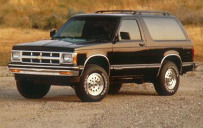

Gold Member Username: Nd4spd18Southeast PA Post Number: 1895 Registered: Jul-06 | 1994 Chevy S10 Blazer. SUV really, but I call the old ones trucks cause they basically are an S series tuck with the back closed in. 4WD FTW (we need it in the winter in PA) It looks kinda like this, except it is a 4 door, the 4 door ones are longer. Not an actual pic of mine: ![]() |
