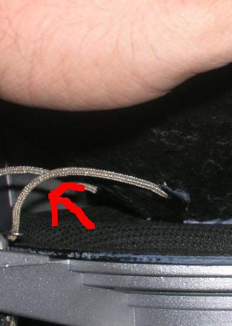

Gold Member Username: WingmanaliveA pic is worth 1000 posts!! Post Number: 5699 Registered: Jun-06 | Have you peaked at the tinsel leads at all? Sh1t happens. Who knows. |
Silver Member Username: Mike11202DE US Post Number: 207 Registered: Nov-06 | Yes, I am disconnecting from the JBL then connecting to the Q and i get nothing. I don't know anything about the tinsel leads anyway haha. Ill take it to an audio shop tomorrow and get it checked out I guess |
Silver Member Username: HgihkcinLincoln, NE Post Number: 139 Registered: Sep-05 | try wiring the Q in a series... the exact resistance is 1.5ohms so ur giving it .75 ohms in reality, which might be the cause.. if it works when you wire it in a series then the resistance is too low. |
Gold Member Username: Adam_s15 TC9 Hybrid, RE MT Softparts Post Number: 1028 Registered: Aug-04 | The red arrow points to the tinsel leads check and see if they arent connected. ![]() |

Silver Member Username: Mrskullz1Brooklyn, New York Post Number: 191 Registered: Feb-07 | dude...steinkea...wtf is that in the top of the pic? finger? hand? lol..scared me for some reason when i first seen it ![]() |
Gold Member Username: Adam_s15 TC9 Hybrid, RE MT Softparts Post Number: 1037 Registered: Aug-04 | Its a hand. lol |
