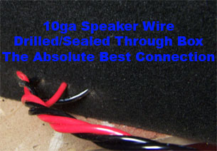

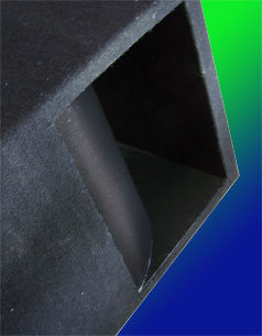

Dual 12" Flair, textured black baffle and port. 10ga wire run through the box and sealed with 100% silicone sealant.
Thx for lookin! Any comments are welcome :-)

Looks pretty nice.I like how it says "The Absolute Best Connection" maybe some of these guys that compete will realize that, as opposed to putting wire to steel bolts.What's the price on that bad boy?

Steel bolts are a waste... thats just more connections in the way. The absolute best connection will always be NO connection... or even copper twisted together. Some say its "cheap"... "crappy", etc etc... but any other way just puts something else between the wire.
thx :-)

I thought you were trying to sell that exact box Mark,that's why I asked the price.Sell that box with the CVRs?As far as the people saying wire through the box is "Crappy" or "Cheap" they're morons.Wire right to the sub gives you the best possible connection with the least resistance.

I've heard it all... Some just love binding posts. I do stock em, and I do use them periodically for those that just have to have them.
10ga wire through the box is good enough for 99.9999999999999999% of the people out there... anyone that "needs" more than 10ga speaker wire direct to the amp probably has more invested in amps than the car they are in is worth.

whats the difference in sound with a side port vs. a port facing the rear? will it change on the mic alot?

^Try it and find out.

jordan, my jeep seems to like sup up port to the side, but i haven't ever tested it on a TL

the end design is what is most important... firing a certain way wont make drastic differences, just dont fire the port forward.
