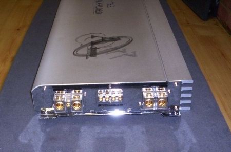

You've never seen an amp with two sets of 1/0 power and ground connections?
For example the Adassa Warlord:
1
And definitely go www.ohiogen.com or
http://stores.ebay.com/Iraggi-Alternator-and-Electronics
for the HO alt
Username: Oleg
Santa Monica, CA USA
Post Number: 807
Registered: Nov-04
niiice now i've officially heard of this, thanks m.s.
does the memphis 4kw have this?
Username: Nd4spd18
Southeast PA
Post Number: 1412
No, so 2 runs of 1/0 wouldn't be feasible with that amp unless there was a battery in the back to connect everything to.
