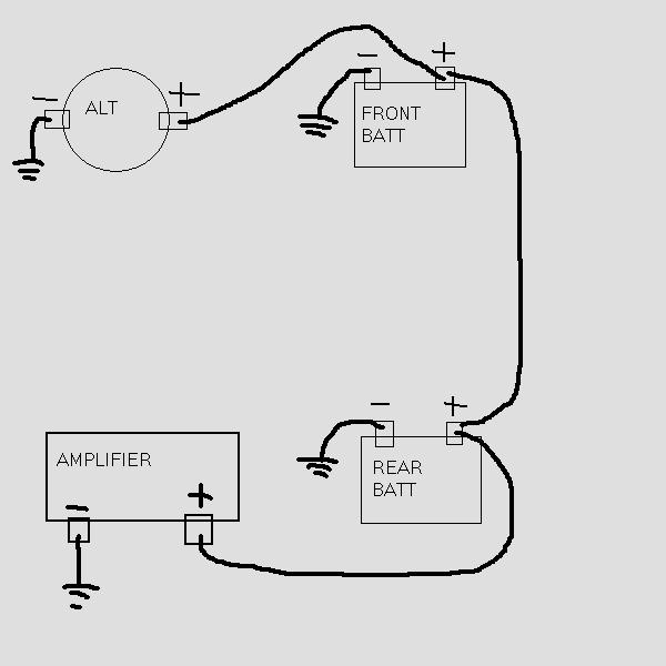

Silver Member Username: Trey4sportsPost Number: 832 Registered: Sep-06 | im ready to wire a second battery so do i just keep the run from amp to front batt and do a run of + to + from the starting batt to the rear batt, and a run of - to - from front to rear batt? OR do i go from amp to rear batt and then wire from the rear batt to the front batt? help me out guys |
Gold Member Username: Nd4spd18Southeast PA Post Number: 1161 Registered: Jul-06 | + to + and - to - Then connect the amp to the rear battery. BTW, both batteries have to be EXACTLY the same model to do that. |

Silver Member Username: Trey4sportsPost Number: 834 Registered: Sep-06 | and i have the batt on the amp running to the front batt, how do i also connect the amp to the rear battery since there is only one slot for battery on my amp? |
Silver Member Username: Trey4sportsPost Number: 837 Registered: Sep-06 | like i know i would wire +to+ and -to- on the front to rear batt but u then say to wire the amp to the rear batt and thats what i dont understand |
Gold Member Username: Nd4spd18Southeast PA Post Number: 1162 Registered: Jul-06 | Justin, yes they do. And even then, it is not an ideal situation. Read: Scan from the latest issue of CA&E mag: http://www.putfile.com/pic.php?img=5112839 Trey, you connect the amp to the battery in the rear. You don't connect it to the front battery since the two batteries are connected. |
Gold Member Username: Nd4spd18Southeast PA Post Number: 1163 Registered: Jul-06 | Trey: ![]() |
Silver Member Username: Trey4sportsPost Number: 838 Registered: Sep-06 | thanks man your a big help ![]() |

Silver Member Username: Trey4sportsPost Number: 840 Registered: Sep-06 | ok one last question. in the diagram, i see that it goes from rear batt + to front batt + but its unclear to me what to do with the -?? i thought you said i would go - to - just like the + to + ?? |
Silver Member Username: Super_marioPost Number: 195 Registered: Mar-06 | CHASSIS GROUND. |
Gold Member Username: Nd4spd18Southeast PA Post Number: 1166 Registered: Jul-06 | " so for now since i have different batteries would i be better off to just swap out the starting battery? " Yes " but its unclear to me what to do with the -?? " Just ground all negatives to the chassis. Rob, you don't have to believe me if you don't want to, but running different batteries together in parallel without an isolator will cause your batteries to slowly kill each other. I just posted a professionally published article that supports that, and there are others online. |
Silver Member Username: Trey4sportsPost Number: 841 Registered: Sep-06 | i got it dude just went back to BCAE and understood. once again thanks, youve cleared up a ton for me |
