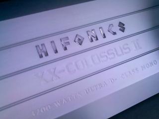

Gold Member Username: Thomas_gNM Post Number: 2238 Registered: Oct-05 | Well first off yeah!!!! I got my xx colossus yesterday, ok i want, no need 2 18" BLs i wanna build sort of a huge box, or wall in my back seat but after sub and port displacement i will only have like 4 cubes each for the 18" BLs, i was wondering if they will be fine if i only have them in 8 cubes tuned to like 32 hz with 154 sq of port area?? Unless i just get 2 15" BLs but will there be a huge difference in sound between 2 18" and 2 15"?? Thank you, you know i alwayz appreciate the input!! BTW i wanna try to do hair tricks so the 18"s will be betta right? And i like lowz. |

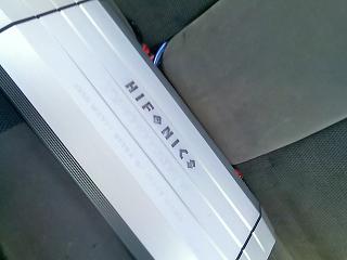

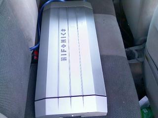

Gold Member Username: Thomas_gNM Post Number: 2242 Registered: Oct-05 |
Gold Member Username: Thomas_gNM Post Number: 2243 Registered: Oct-05 | FUKIN PIECE OF SH!T!!!!!!!!!!!!!!!!!! Ignore that tiny azz picture, im tired of resizing it already. | |
