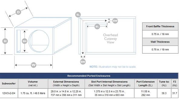

If I make a box with these specs, would it be tuned at 22Hz?
AND
If I make the port smaller will it be tuned at a higher frequency.
I was told that it should be about 30-35Hz.

use this..its a lot easier
http://www.subwoofertools.com/forum/ported-box.asp?Ew=38&Eh=14&Dia=6&Xmax=20&Vd= .11&NumW=2&Vb=4.0&Fb=40&Qts=&Vas=&Fs=&CE=0

That is not enough port area for really anything.

ok should I do this one...

Looks like a JL design to me. Can't go wrong there. Thats the great thing about spending the extra cash on JL Audio subs. Excellent support. No need to figure out anything. If you can use a tape measure and a skill saw you can build a great sounding enclosure.

I just realized how good of a design that is...
its like the perfect box...
