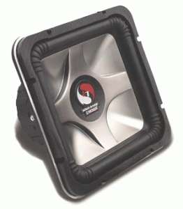

Hey. While I am waiting to make some money this summer for an upgrade, I figure I may as well make this L7 sound as good as possible and get some feedback on my box building skills before the real thing. I am home for spring break next week and think I will build a ported box for my 12" L7. What do you guys think about 1.8 cubes at 40hz? Feedback? Thanks!
Username: Mgbcs
Lincoln, Nebraska
Post Number: 460
A little more info...it will be in a 2000 Sable with stock charging. The amp is a Kenwood KAC-9102D mono claiming 850 RMS, so maybe closer to 700RMS.

Well that last question is still out (what does 2.75cuft give me over 2.00cuft), so if anyone can help that would be great. But also, I am not sure if the xmax and displacement are the same as the current models (14.1mm and .17 cuft). I have an old model one. Upload
