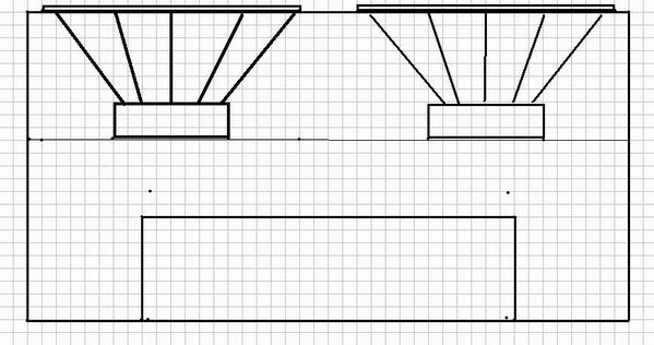

this is my design for two 18" BLs. they get wicked loud but they seem like im pushing them too hard sometimes with only around 1000 watts. i think i need abit bigger box but im not sure.

You are prolly pushing the amp(s) too hard...not the subs.
If you go to a bigger box, the subs will not handle as much power.

that box is too small for those subs though. they recomend 5-10 cuft but you are looking at around 3 cuft per sub.

I just realized how small that box was...looks like ~4.5-4.75cuft.
I would prolly run 1 15 in that box.
Try 12-14cuft net w/ those 2 18's.

that box is around 8.5 gross. i would say the port takes up a good 2 cuft if not more. also your driver displacement.

you can do 42w x 22h x 30d and that will give you 13.5 cuft gross. with the port and driver displacement, you would see around 11 cuft net. that should work perfect for those subs.
do subs up and port back this time.
to give you an idea how a bigger box would sound, take out one of your sub out. plug the hole and run just one sub to see how it sounds.

chad, lemme change that around to 42 wide x 24 high and 28 deep. think you could help me with a design? simple slot port out the back?

yeah those dimensions would work well. if you don't too much port displacement, you can do 4 6 inch aeros out the back. the subs up. also with that box size you can do separate chambers.

can you throw together a design for me? i just need to know what to cut really...
42 wide, 24 tall and 28 deep. subs up port back. tuned low 30s. i will add the double baffle making it just shy of 25 tall, which is the top of the backseat headrests...

42w x 24h x 28d = 14cuft gross.
driver displacement is .23 x 2 = .46
port area........26inches wide x 8 inches tall and 16inches long giving you 34hz tuning.
here is a view from the rear.
KINETIKLos Angeles, CA
Post Number: 10869
each square is 1 inches.

you can make the ports interchangeable. when you do the cut out for the sub, make it as close to the front as possible.
you are lucky you can do a simple square box. i hate working with angles.
btw sorry i don't have the fancy program to use to show you a better pic. for some reason google sketchup won't work on my pc.
