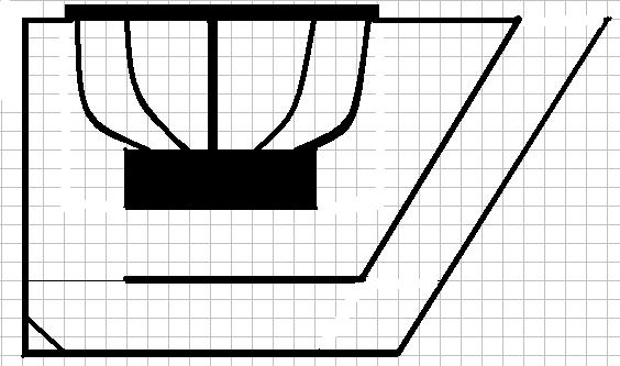

I need everyone's input on my box design
Www.15inchwangers.comFI Audio BTL
Post Number: 10566
here is a pic of my new box design. i already stated on it. i have the sides and bottom already cut. before i start cutting wood for the port i just want to know what everyone thinks.
the box specs.......
6.2 cuft after driver and port displacement
154 sq inches port area. 4" x 38.5"
tuned to 36-38hz.
the pic you see is a side view of the box. the port will go across the back part of the top of the box. the port will fire in to the rear window.

Utter shite. j/k lol. I like that design alot actually. Are you going to put one of those new DD 18's in there? Cuz that box is huge. I think with your new batteries and this box you're gonna hit 150+ for sure.

Chad I really hope that the pressure reflects off the rear windshield the way you hope it will...lol.If not you're going to leak badly and you're going to lose DB,let's pray for the best on this one bro.

yeah rob. that is exactly what i am hoping for. it will reflect well cause my rear windshield is solid as a rock. lol. i hope.
brad that will be for 2 btl 15s. each driver will get 3.1 cuft each after displacement so it just barely meets the requierment.

Looks good. Just hope it actually works out as good as it does when you designed it.

Chad you might actually blow your back window out of the seal lol...it's pretty possible too lol.

Wait, is this a box that you're hoping to get to 150 with? Tuning is a little low, I would think it's a daily driving box?

rearrangeyamind.......i know it is tuned a bit low for spl. but i am hoping the port area compensates for the low tuning. also i am mainly trying to be in the 140-149 bassrace class. i am hoping with this new box i can score around 146-147.

I'm not into SPL and comps so disreguard this question if it's stupid but.. Why not tune it high AND have a large port area?

as long as i am close or at 150 i will be fine. like i said above though, i want some killer bassrace score.
btw i think ima tune it to around 38hz.

since u got the set up in the seats ill do like a wall, since ur 50% doing that. go ports firing to the widnshield and do flared ports too but the big ones u might ask marshall white to make you some 9INCH ports, then when u have the box use another mdf panel to make it like a wall so no air or pressure can go in the back.

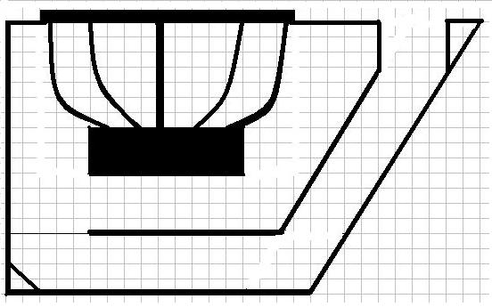

thought about flared ports kingrob but it won't have the clearance for the length.
how about this way guys.

I think either way isnt going to be that much different. Stick with the first one and get a little more volume lol.
Post Number: 10577
yeah i like the first one myself.

wall if u can get 9 inch the lenght wont be too much problem. i can get like 4 9 inch instead of the 4inch ports. wat u can do its to make a flare but slot poter but will be too hard. u can do that desgin u have. but make sure its all firing to the front. so the pressure goes directly to the mic like i siad try makin someting for the box like a panel for the box makin the air keep going str8t to the mic and not escape to the back

i like the first one better really

First one fo sho.

I'm wondering if less port area and more net volume would be better...?

It's all trial in error and for his goal in SPL he's going to have to keep testing and he will find what works.
Post Number: 10580
i am trying to go with less net volume so less imp rise.
