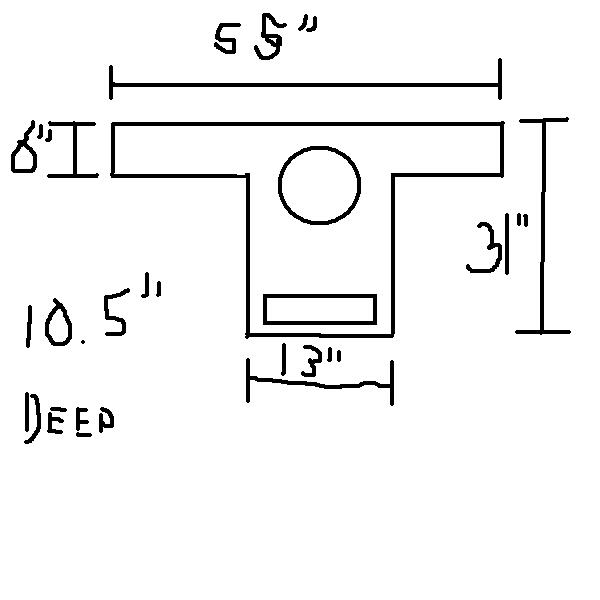

ok here is my box. but i cant seem to figure out how to calculate the internal volume so i can calculate the port. can anyone help me out?
sorry for the sloppy drawing. the box will be in a single cab gmcUpload

it is 3.97 ft^3 befor sub and vent displacment. but you have to acount for wood thickness. if the measurements above are inside dimensions then it will be 3.97 ft^3 but if there outside dimensions then the ft^3 will be smaller depending on wood thickness.

yeah those ar outside demensions. the wood is .75" thick. so it would be around 3 ft^3?

2.7

would this amount of airspace be good enough for a Fi 12" Bl?

the website says it likes 1.8-2.5 cubic feet
the vent will prob take up .7 and the sub will take .15 so the total will be about 1.85
how much power u giving the sub?
also sence you dont have much box volume to work with i would recommend using aeroports becuase they take up a lot less room

im going to be giving the sub at least 1000 rms. probably a hifonics 1206 amp. what are aeroports? sorry im not familiar with these. but i wanted to go with the vented because i could just have the port on the front center.

Aeroports are a way of porting a box they are tubes that are somewhat like PVC pipe but they are flared at the ends for smoother airflow. Here is a link to where you can buy some.

if i added two more inches in depth, how much airspace would i have?

by my calcs it should be 2.97 after all displacements right?
