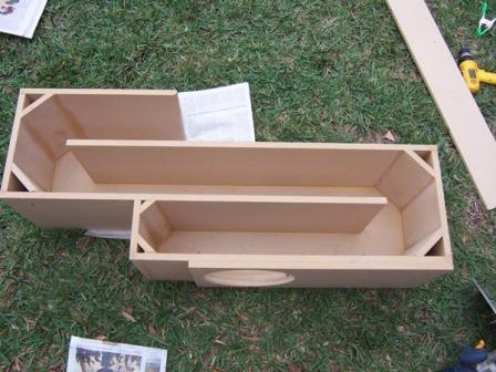

Gold Member Username: Tdeaton1021Near Tampa, Florida USA Post Number: 3816 Registered: Sep-04 | Here's an enclosure i built for a friend. its going to replace the front center console and go back into the rear seats acting as a rear center console as well. its a true T-line tuned at 26Hz for a DD 2512. i cant wait to see how it sounds. it looks awesome. once this thing is all vinyled up and everything this will definetly be one of my best boxes, given that it performs, which i have confidence in 8) Here is a look at the inside ![]() |

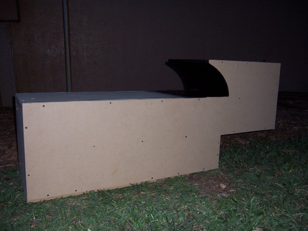

Gold Member Username: Tdeaton1021Near Tampa, Florida USA Post Number: 3817 Registered: Sep-04 | Here is a pic upright. the sub downfires and port fires forward. the port is painted black and theres a little shadowing on the wall behind it because of the flash as its getting dark... ![]() |

Gold Member Username: Van_manBoston South, MA Post Number: 1941 Registered: Mar-06 | Da m, that looks nice. Nice build. x2 baffle, Bracing, you got it going on. Wheres the drink holders? |
Gold Member Username: Tdeaton1021Near Tampa, Florida USA Post Number: 3818 Registered: Sep-04 | we are actually covering up the drink holders lol. the only reason you need a drink holder is if you not drinking...so then what do you need a drink for if you need a drink holder? lol the design took me about an hour to figure out and engineer. i dont use any programs so i draw it all by hand with pencil, paper, and ruler by the scale of 1 inch = 5 inches. then it took me probably 7 hours after that. partialy because of the damn angled pieces!!! die you evil spawns of s@t@n!!! sorry... they were a pain as my skill saw kept curving somehow even with a straight edge.... so yeah they took like 90 minutes atleast... then my dad tells me "you know we have a table saw" me- you mean thats not Artistic's? him- "no its ours, i dont keep it here because it doesnt get used" me- didnt you notice how dirty it got when it was here for a week? him- "yeah i guess so" me- thats because i used it all the time!!!!!! ah i could kill him lol. so hes gonna bring it home again for me lol. oh and my crappy jigsaw... i hate it... if i had a good jigsaw, and the table saw for the angles... it would be like 4 hours lol. |
Gold Member Username: FrkkevinResonant Engineering..., Fort Worth... Email Post Number: 3032 Registered: Nov-05 | you should not have flused the front baffle.. this way the sub had room for excursion.. you have legs going on it to hold it up? nice box though.. be sure to post final pics |

Gold Member Username: Tdeaton1021Near Tampa, Florida USA Post Number: 3820 Registered: Sep-04 | yes the box will be held 3 inches above the floor by "stilts" thanks for the compliments guys! |
