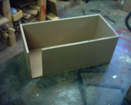

is that for a 12 or 15 and how longs that port?
Username: Logan__tille
[:-]15 Wangers Club[:-] Premier Member
Post Number: 5688
A 15" ssd. I dont remember how long it is, but its has like 76sq inches of port area.

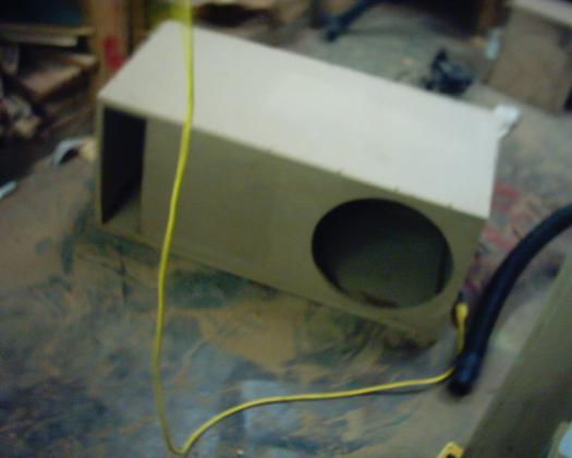

did you inclute the hole for the conections, i didnt saw that in the pic... and where are you ?? i want to know the estimate on the shipping if i get a box.
Post Number: 5692
Yep thats my shop. It is going to have a speaker terminal for the conections. I am in Hamilton Indiana.

should L'ed the port rather than the way you did it.. better flow.. less port noise.. even though you tried to cut that by 45 each edge ... :-)
looks good though

^^^^ Comin from a Noob... Its an SQL/SQ box..... :-O Polo...
Username: Frkkevin
Post Number: 3030
^^^^ Comin from a b000b
lol :-)
technically the port is suppose to be the same length away from the back wall as it is wide for best results :-)... but given dimensions in most cases the install won't allow that
Username: Safe_cracker
Chicago, IL US
Post Number: 2429
Umm look at it again, the internal opening of the port is no way shape or form near the wall... Polo..
Username: Frkkevin
Post Number: 3031
you mis-understood what i said :-)
port width = port length from the rear baffle = best results..
but anyways.. itll sound good
Chicago, IL US
Post Number: 2432
I understood what you said but that isn't always true. With as low as that box is tuned to the movement of the air will be lower hence it won't matter much as for turbulance will be low to begin with. Now the end of the port technically doesn't have a rule other than there being a port widths of space between the back baffle and the port opening, this is a minimum and not a maximum. Polo..
