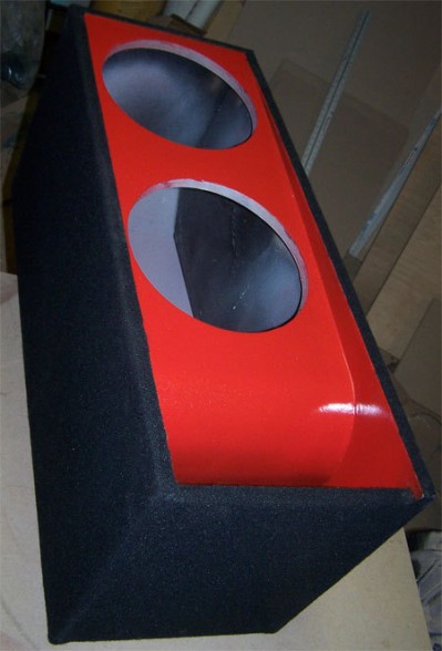

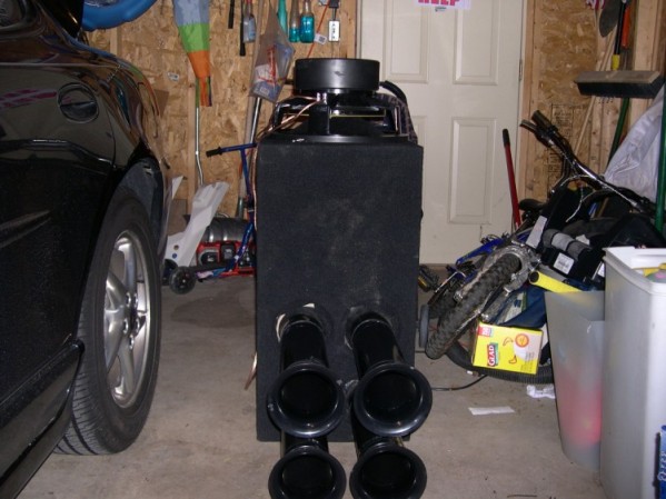

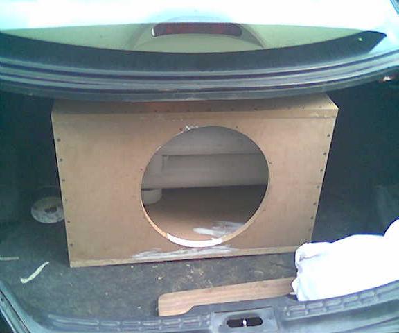

You would not want an aero box tuned so low. Idea of an aero is to allow for higher amounts of air movement with minimal amount of turbulance/port noise. Now with that said, the lower the tuning the slower the air is traveling, hence the less need for aeros. If you want a low tuned box then go with a slot port, much more practical. if you want an aero box then go at least 38-41 hz on the tune, a bit easier to manage. Also one thing to remember, just by the shear shape of things, a round port naturally produces a wider array of frequencies, meaning it will be less peaky around its tune, will hit low and high so a higher tune would be beneficial. In my honest opinion, slot for a low tune and aeros for a mid-high tune box... Here is a pic of my aero which holds a 41hz tune, but peaks in car at around 38hz. The slot is a custom I am having built but with a single opening and it will be tuned to 35hz.. Polo. :-)

Well, i did that origianally, but the box was to big to get INTO the car. I drive a 99 sable and the trunk is HUUUGE, but the space to get anything in the trunk is only 32x17x12. So now, my thinking was to either look at 2 individual slot port boxes or a aeroport, because i was thinking it would be better to build those, rather than a smaller cubic foot slot port box. Thoughts?
Username: Adam_s
15 TC9 Hybrid, RE MT Softparts
Post Number: 583
Registered: Aug-04

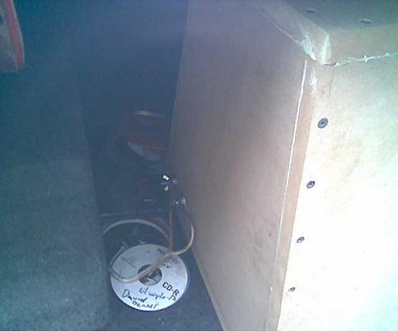

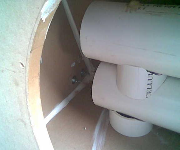

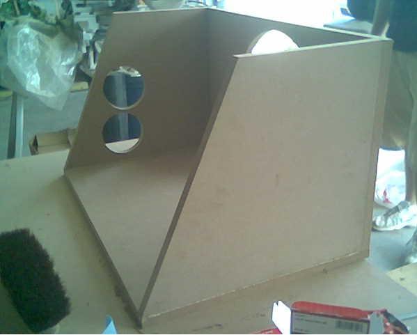

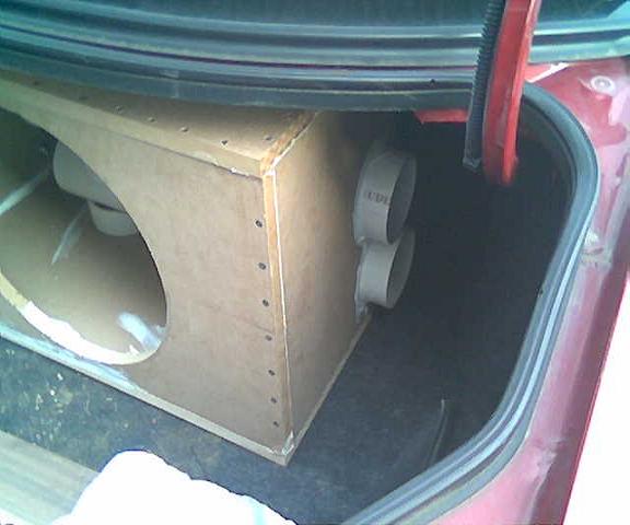

Ahh ic. I have a 97 sable. I understand where you are comming from. I had the same problem. Huge trunk stupid shaped opening. In that case I would just say just do 2 4 inch ports. Thats what I did for my box.
Here are some pics of my box.
Username: Adam_s
Post Number: 585
Registered: Aug-04
If you dont want the ports inside the box they could be external like in Polos pic.
