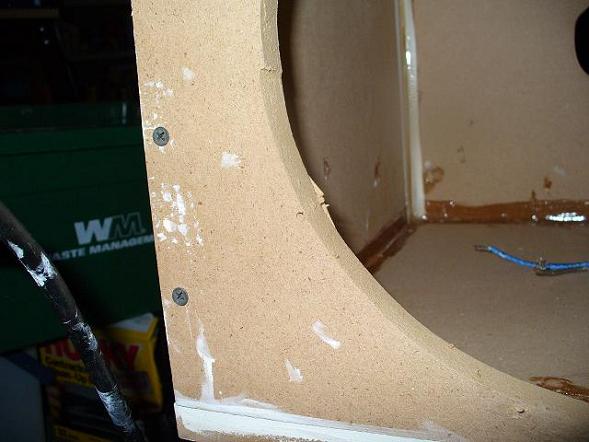

My friend isn't the greatest with the jig saw and the subwoofer hole is a little screwed up. One screw hole is right on the edge, and the other one has barely anything to grab. All the other ones are fine.
What I was thinking was get a new sheet of MDF cut to cover the front (up to the port) and recut the hole (in the same location as it is now). Should I do all of this or is it good enough?

Wow, he does suck. Put a second baffle on the box and cut it right this time. Besides, a second baffle will give you less flex.

So get an mdf sheet cut to fit this red outline? Should I worry about adding trim pieces around the port so it's not 3/4" lower than the front of the box will be?

ya around the red line, but you can make it like 5 inches away from the port so that the port isnt affected.

yes i would advise u to put a new front baffle & honestly IMO if u did extend the port by 3/4' when u put that new baffle most harm it would do is drop ur tuning lower by a hz if so much ......

Just cut a new baffle, attach it and re-cut the subwoofer and port opening.
3/4" isn't going to effect the port tuning by that much and you won't notice the difference anyways.
And, for the love of god, cut the subwoofer cutout alot cleaner. It's not rocket science to cut to the line with a jigsaw.

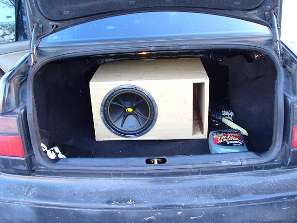

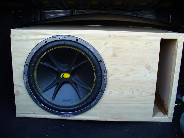

Well I ended up leaving the crappy hole, and not adding a new front board. This won't be for good, just a few weeks until I am off from work again.
This thing hits sooo nice. I can't turn it up too high or everything in the track rattles (and you can hear it from the outside). I can even see the rear quarter panels flexing.

^^^is that contact paper u used ? - looks alot better now , u just nned to paint inside the port & ur good to go .....
Username: Gibson5469
Post Number: 88
Yea it's con-tact brand contact paper from home depot. I wish it was perfect, but we had a hard time getting it to stick on the edges. And the crappy subwoofer hole bothers me a little bit, but I didn't feel any air leaking out, so it should be fine.

Yea, you can probably tell this was rushed. I didn't cut anything but the holes for the sub and wire terminals. I had the guy at home depot cut all of it, and it was all off a little bit . With no table saw, doing this at home would have been damn near impossible.
