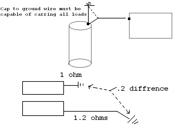

Username: Van_man
Boston South, MA
Post Number: 1864
Groundloops are the diffrence in voltage between two ground points.
Say amp 1 is grounded here, amp 2 there.
they both make their way back to bat neg. now amp 1 has 1 ohm of resistance to ground
amp 2 has 1.2 ohms of resistance to ground. That .2 is noise.
same being for cap. If you use one ground point, say a bolt on the chassis. and the cap is grounded ther, and the amp is grounded there, then technicly moving the amps ground up to the cap is still the same. 1 path for ground.
