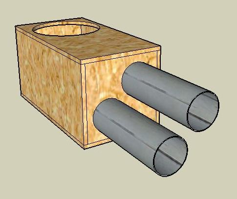

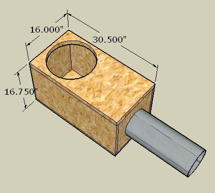

3.23cuft net tuned to 46hz to start off...This will be a new SPL box for my 9515d.
Either going w/ 1 8" flared port:
Or 2 6" flares:
Should be interesting :-)

what are the benafits of haveing the ports stick out like that ? ( this might be a noob question srry )
Username: Southernrebel
Post Number: 4265
Registered: Mar-04
less air turbulence inside the box.

im figuring the box can be that small since the ports r outside the box & it being strickly 4 SPL purposes .......

im still confused. in most SPL application dont they go above reccomended volume? what calls for a smaller volume? just a test?

you go canaan,if that works thatd solve my prob of ports being too long for my box.
