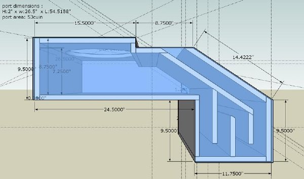

There is enough room for a ported enclosure for a 12" about 2.5cubes after sub and port displacment.

Box wont be as easy to build as a normal ported enclosure but it can be done if you have the skills.

where did you get those kebo? you make them yourself? the drawings i mean

I acutally got those from another forum and if you are wanted ported you arent gonna get 2 of them.
