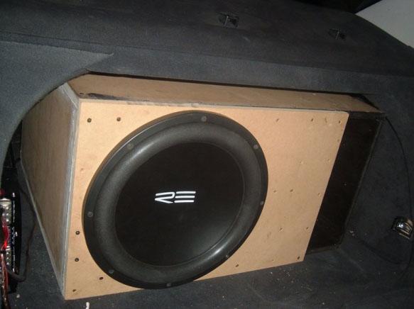

Username: Frkkevin
Post Number: 2557
I'm running a single RE SX 15" for now.. port is 14.5 x 4.5
The only pic that I could find right now is this one.. im not running it like that and the box does not look the same now.. but it is the box lol.
Fi Audio BTL
Post Number: 8862
that is insane man.
Username: Frkkevin
Post Number: 2559
heres the current setup
.. but it will be changing :-)
