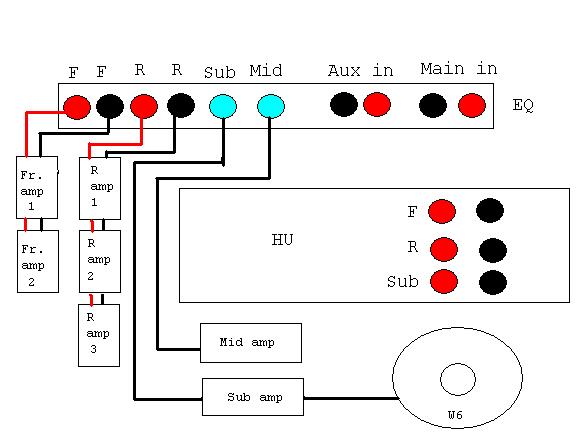

Well Im setting up my new system, but am a little stumped about this one. The HU has a lot of tweek settings built in, But I still want to use an EQ. Anyway, Normally I would just run the front HU RCA's into the EQ, But would It be Wise to "Y" the Front and Rear together? Not worried about fade/balance as the EQ will take care of that.
So as you can see, the EQ has one input, but the HU has 2 plus sub. Any Suggestions?
Thanks.

no don't put them together that will just mess up your signal. all you have to do is just hook up your front from the deck to the eq.
p.s what eq did you get i have an eclipse that i really love they are great eq
the way my eq hooked up is front rear sub from amps go into the eq and the front from the deck to the eq
i hope that help
