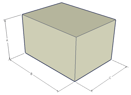

THEY MAKE THE BOXES SO GOOD LIKE TEMTOXIC BASS ITS THAT THEY USE THE MOST SQ INCHES OF PORT AREA AS POSSIBOLE AND THE BIGGEST VOLUME IN THE BOX, BUT THEIR SECRET ITS THAT THEY USE THE GOLDEN RATION. AND THEY PEAK THEIR BOXES TO HIGH TUNNING AND THE GOLDEN RATION MAKE THOSE TUNNINGS SOUNDS LIKE ITS TUNED LOW.
The secrets to the best sounding boxes. This can be applied to sealed and ported enclosures. You will notice a big difference even between a standard sealed enclosure and the Golden Ratio sealed enclosure.
SHHH DONT TELL NO ONE :-)
The Golden Ratio should be used whenever possible unless there are a space restriction. These dimensions will sound less boomy, have less panel vibrations, and better (transient) response.
The Golden Ratio:
1 x 0.7937 x 1.2599
Example: Desired net volume is 2.00 cf.
Take the cube root: 1.26 ft = 15.12 inch = Side A. Now multiply side A x
0.7937 to get side B, or 12.00 in. Side C = side A x 1.2599 = 19.05 in.
So we have:
Side A = 15.12 inch
Side B = 12.00 inch
Side C = 19.05 inch
The closer you are to the Golden Ratio, the better the response.

HERES THE GOLDEN RATION
the formula is
The Golden Ratio:
1 x 0.7937 x 1.2599
ok for example u want umm let see u want a 3cb ft box wat u do is this
1)-take the cubic root of 3cb ft+ its gonna be in inches dont know how many then this result will be your side A.
2)-then u multiply your side A (the result u got above) X 0.7937 and u will have side B.
3)-then to get side C u need to multiply your side A (the result on number 1) x 1.2599
u can vary the shape of the box like if u get on side b 15 inches and u think is too much u can take some inches but THE CLOSER TO THE GOLDEN RATIO THE BETTER.
now u have the box then your final option its to calculate and built the ports. NOTE___ that the 3 cb ft will decrease the volume because port displacement so calculate your box volume first.
for example your ports are gonna take .23 cb ft so before u do the golden ration your 3 cb ft box will be 3.23 cbft
now did i answer your question correctly jaymes??

Rob, what if the box were to have a slot port? Wouldn't that change the dimensions?
Username: Extrmndor3
Im pushing i... And pushing ...
Post Number: 3038
ok lets see u make a slot ported, the square port will take out like .75cb ft and u want a 5 cb ft box now wat u do its before doin the golden ration box add the port volume to the volume u want so it will be 5.75 now do the golden ration formula using 5.75
