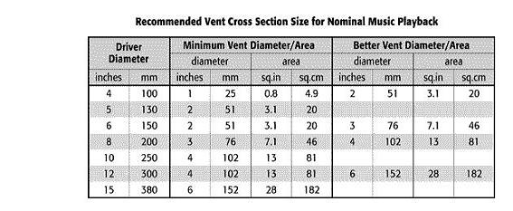

Platinum Member Username: Rovin1 12 Premier... Post Number: 10233 Registered: Jul-05 | i found this online a while ago may not be the most accurate but its better than nothing .... ![]() |
Gold Member Username: CenusHicksville, Ohio Post Number: 2727 Registered: Jan-05 | cool thanks rovin, atleast it gives me some ball park figures. |
