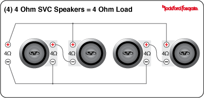

you'll have to wire all your 6.5's to a 4ohm load, and then wire the fi X to a 4ohm load also. since the amp does 300x2 at 4ohms per channel. I'm sure you knew this, it should be fine.
Wire your 6.5's like this if you didn't know.

you have to wire it the way I showed you, or else your mess up your amp. Doing what you mentioned will give a ohm load of 2ohms at channel 1 and 2 and then a 4ohm load at channel 3/4 bridged. that 2ohms on two separate channels will probaly, and most likely kill your amp. So wire it the way I showed you. If your not confident, then do what justin said, get another amp for the sub alone.

ok if i follow the diagram.. so the + will go into the + of ch1 and the - will go to the - of ch2? right ? and same thing with the subwoofer the + will go to the + of ch3 and the - will go to - of ch4.

if thats what the amp says then yes. because some amps might say to bridge for two channels you have to bridge 1 and 3 and 2 and 4 I don't know if its true but I'm taking a fat guess. But if thats what your amp says on the amp or w/e then yes. and just wire the speakers for your 6.5's in that picture.

That is exact back of my amp...
OK take a look at the pic in the link.. that is what i understood .. is it correct?

Username: Bernymac
Cambodian
Post Number: 1478
Registered: Sep-04
correct on the speaker part. but what some people would do is only run one wire to the amp and not two like you did. You see how you have two red wires and two black wires. Some people would just wire this positive from the speaker to the other positive on the other speaker and from that speaker run ONE wire to the amp positive on channel one. Same goes for ground. But I'm not sure, you can probaly do the two + wire and two - wire from speakers to amp. Let someone else clear that up. but you got the right idea so far. I'm just confused if you should run two wires or run 1. I would do it the way it shows in the picture I gave you.
