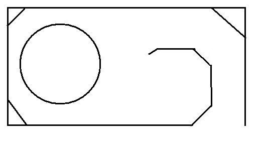

alright u might of seen my last post but no one loved me :-( anyways i have a single slot port design box sub is up port is back its 6.2 cubed tuned to 35hz and its loud i was thinking about doing a dual slot port one left and one right and sub up in the middle u think this could enhance it or what design would u go with btw i drive a hatch roush i love u guys thanks :-)

sub up and 4 4inch aeroports to the back.

i wouldn't do a dual slot port.
btw how much port area do you have right now?

i forgot to be honest work it out though its 18.5 high 4 inches wide and 15.5 long

thats a good size.
if you are gonna do slot port again, try rounding the corners.
this is the design i had in mind when i had my re sx 18.

or like this.

this is a focus hatch? .. i've seen two kicker comp 15s do a 149 with subs/port up
but i'd do sub up and port back.. with the 4 4" aeros youll get less port noise and less turblance = more dB :-)
don't do dual ports.. keep ports on the same plane if your doing aeros.
how much power are you sending it btw.. if it is not loud enough i have a feeling it is not getting enough power :-)

no its loud bro...but as u said power is an issue right now..im searching but im wanting 1400-1600wrms on it soon on my buddys mm1000d i metered it at 146.2 so im thinking with my amp im getting and the aeroport design i should do better

you think 3 6" flared ports would be fine for that box on the bottom in the same plane so sub up and ports holes to the bottom 3 of them?
