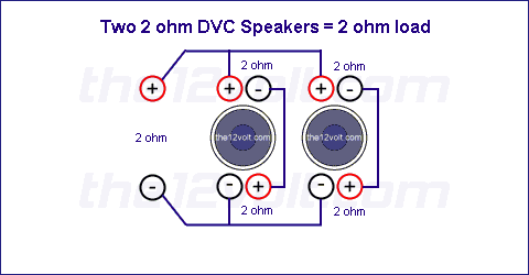

wiring for 2 dual 2 ohm subs are:

^^the first pic on there gives a drawing of how you wire the 2 subs to achieve a 2 ohm load for your amp.
and you are fine with the amp you have

there werent any pics up there, my bad, here it is for you.

alright man thanks alot
i appreciate it
