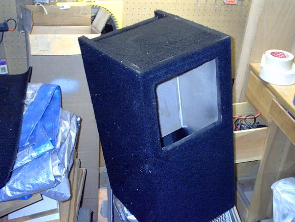

The 3M has a good bond, but is $$$$. Some stores carry an off brand thats 1/2 the $$ of 3m, but it takes longer to set up, and you need more cans to a box. 1 large can of "77" will do most boxes. 1 coats on the MDF, and 1 on the fabric, vinyl, carpet, fur, or whatever you decide to cover it with. I personaly like fabric. but carpet is very forgiving to work with. Over lap the seams, cut thru both layers, remove the bottom cut piece, and walla, a perfect seam. Fabric, you gotta match the pattern at the corners.

I switched from vinyl to carpet.
I find the carpet more practical and a lot easier to clean.
I also personally prefer the "common" and integrated presentation.
I got the carpet from www.partsexpress.com
...the vinyl from www.selectproducts.com

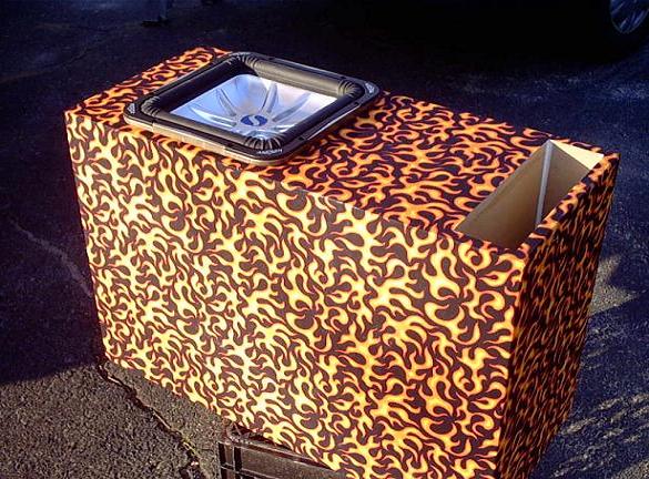

Well, Joannes had a wall with about 15 diffrent vinyls, all colors and textures for about $7.50 a yard.
There was also a lot of other stuff too. Headliner material, pleather, suade, and leather.
Also had a section with skulls and flame stuff.

Heres a bunch of skull stuff.
http://www.jandofabrics.com/products.asp?id=128&viewall=True

Carpet is the most common. You can get good box carpet online from partsexpress.com. Use the "cabinet carpet" they have. Its unbacked and very easy to work with. For glue, go with 3M super 77 as mentioned. Its around $9 a can, but its GREAT stuff.
As far as the actual process, here is a tutorial I did for another forum: http://www.caraudio.com/forum/showthread.php?t=150453&highlight=carpeting
