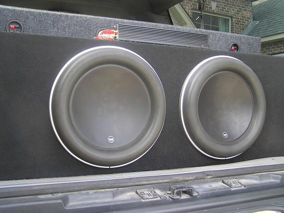

i like your system man, nice SQL setup
Username: Logan__tille
Post Number: 3026
I love the way thoes W7s look. Thoes ports seem kinda small...but how does it sound?

i think it could be louder, my orion 2500d comes in on friday, or so says ups, so im hoping itll be better then, and i wana build a higher tuned box, becuz sql is rediculous and spl isint to bad, but it could be better wit these two subs, ya know? im worried the box isisnt
1. big enuff
2. tuned high enough

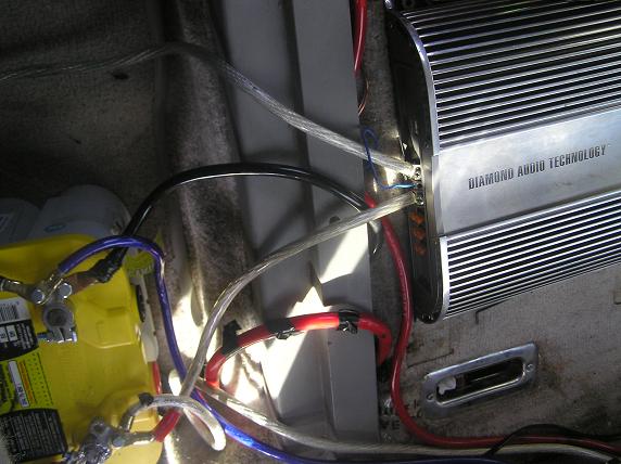

nightmare isint even doing it justice, its a 10minute process to figure out whether a 2 gauge under the carpet is ground or power, and ouch, that fu*ker was definetly power

to many speakers i think. toy dont need 12 tweeters in that car, or a 15 farad, cap. + two yellows and 1 red-top, do you have a HO alt?

I honestly if anything with those JL's, I'd tune them lower if I messed with them at all... Possibly 32hz. A local kid here has 1 13w7 on a jl 1000/1 tuned to 32hz, that thing got low and nasty. Also, are you running all of that off of your stock alternator? Any electrical problems? J/W, how old are you? lol

22 boston AND power acoustik tweeters, AND marine speakers haha nad i bet u still have voltage drops man look show u wire your batery but it looks cool

well try to get a better battery terminal and tigh your connection better, and if u can upgrade your wire make the cable as short as posiblem, and your cap place it next to the most power full amp u have, and make sure the wire between your cap and amp is not mroe than 6 inches. also dont mix soft and hard tweeters expect soft fron and hard in the original rear speaker door opening so u can barely hear them,
replace all your 6x9 to 6.5 they will get you better midrange since the design of the oval make it god for low end but not that good ofr mid end, try to buy some cdt components for your front and back doors that only two comps ull need u willnot need 22 tweeters and 6 6x9'.
do the big 3 on your alternator or run a postive wire from your alternator to you positive battery and put a cable on the ground of your alternator housein to the chassis if ur using the chassis for your ground on your amps or run to the negative batterie if u have extra run for negative on your amps.

Where is the relay for the CAP? You have to have it or it will drain your battery FAST! Also what frequency do you have the 6x9's and how much overlap with the subs? The reason why I m asking is if the 6x9's are sharing any part of the subwoofers frequency you may be experiencing some cancellation. try running your subs without the 6x9's to see if they get louder, if they do then reverse the wires either in the subs or the 6x9's. Polo. :-)

Here is the wiring diagram> http://www.alumapro.com/docs/cap15wiring.pdf
Trust me when I say you need it, I have one sitting on my work bench(CAP 15) because I don't want to complicate my wiring with two relays so I got a regular cap. I will sell it if you know anyone who wants it, Polo..

DONT use that.juzz wire all parralel, that relay is juzz like a insulator and are BAD they cause voltage drops iraggi and excessive dont recomend them. DONT USE THEM
Username: Safe_cracker
Chicago, IL US
Post Number: 2128
You can't use a carbon cap without it! There is no internal shutoff so it can and will kill his battery. Polo.
Chicago, IL US
Post Number: 2129
From what I have heard it draws a continuous amount of amperage, pretty significant at that so with the vehicle off it will draw it from the battery. The 5W resister is what cushions (charges) the cap before the relay kicks over. the main relay is for isolation only, the little one is just a ignition trigger.Polo..

well if u have to use that well dont use it thats wat causes the voltage drops so u should get a kinetik hc600 its a regular small batterie but with charge and discharge of a cap ihave one and its cool but i stil lhave dimming :-(

ports fire directly into ur back door?

Did you know a standard battery will produce more power, faster due to the lower internal resistance. A yellow is purposely made with a higher internal resistance to control the flow of current. By itself, the yellow will last longer because it discharges slowly BUT it also limits the amount of current going to your system. Do yourself a favor and ditch that yellow top. I would love to hear Metallica's One on your system, that has got to be vocally loud! Polo.. :-)

yea the whole box is less than 6 inches from the back door, for some reason its loudest this way, ive tried facing them up, towards the driver, but rear firing is the best

the orion 2500d, is that gunna blow my w7's cuz right now im worried there underpowered, and now idk if thats to much power sine
JL says approx. 1000 watts rms

no it wont be too much, its prolly just right
