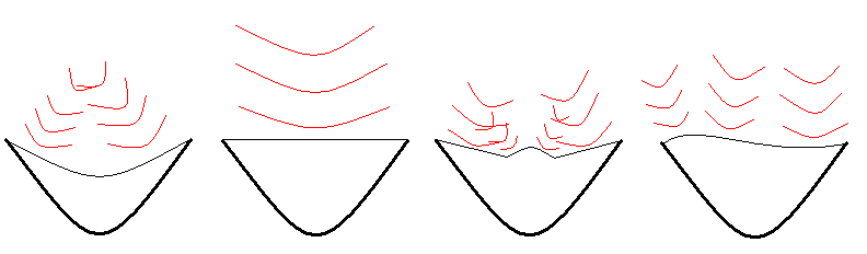

image/bmpUpload
its what speakers do.bmp (92.0 k)
i drew that a while back.... hope it helps

nice description troy. so the flat cones would have better sq.

so basically all the waves froma flat cone are the same and go in the same directiion...right?

There really isnt a difference when it comes to a subwoofer. The cone acts as a piston if properly designed regardless of actual shape. Flat, curvilinear, straight or odd with all sorts of pressed in shapes that look pretty made out of poly.... it really doesnt matter if it is rigid.
Now for a full range or a speaker playing in a higher passband, cone shape and geometry makes a HUGE difference.

if a cone is rigid it wont distort as bad and the way i look at it is a flat cone is the opposite of distortion so i would say it has better SQ jmho

it also has a flat (off axis) point, which = better control which= better SQ. Now this is all on paper in the natural world? who knows.
