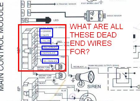

New member Username: VaggabonPost Number: 1 Registered: Dec-06 | I am getting ready to install my HT-800D and am curious about 2 things on the install diagram. What do I connect to this engine pic and what is the brown wires for? Double pulse/single pulse lock/unlock? ![]() |

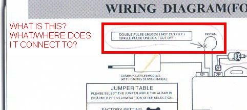

New member Username: VaggabonPost Number: 2 Registered: Dec-06 | Also, what is this for? ![]() |
New member Username: MmouseTorontoCanada Post Number: 2 Registered: Nov-06 | Emmet: ***Engine means that you cut the starter wire and one connect the two thick wires of the relay on to the starter wire part that heading to plug, and the other the second part of starter wire which exactly heading to starter engine. *** Brown wires are for turn signals so when you arm/disarm the alarm they would be flashing. *** The single pulse/double pulse wire if cut opens only driver door, if connected all you can open only driver door with one press on button or all doors with double press. |
