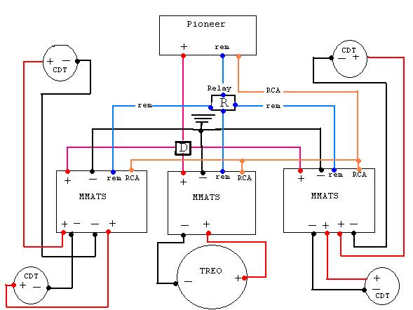

Gold Member Username: Van_manBoston South, MA Post Number: 1251 Registered: Mar-06 | this may help you out. D= ditribution block. Notice the relay on the rem? And pass thru RCAs or use "Y" connectors. ![]() |
Gold Member Username: Dustin3Tigard, OR U.S. Post Number: 4162 Registered: Oct-05 | nicely done marc ![]() |
