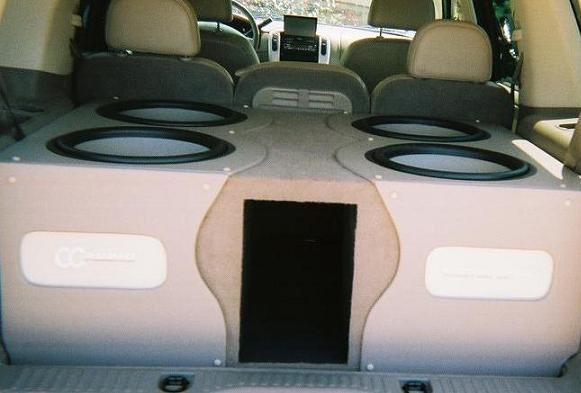

Username: Jakeyplaysbass
St. Louis, MO
Post Number: 1531
looks like my box.

damn i hope i dont infringe on any copyrights lol...that looks real nice...what kind of 12s are you runnin?...im goin to run 4 DD audio 1012s on an orion HCCA-D5000.

There ED 16ov.2s and 2 ED NINe.1 amps strapped at 2ohm.
153.7dB on a TL mic was my loudest. There hitting close to 152.6dB now. The box is tuned to 33hz with 126sqin of port, 13 cubes before displacement and like 11.2 after.
Everythings coming out next weekend..It's time for something new.

damn thats great...whats the RMS wattage on those subs? and really close to my box lol...im running 11.4 before displacement and ports tuned to 33 Hz. did you build the box yourself and if so how did you do the vinyl trim peices on there?

A shop by me did the vinyl trim and plexi inserts. They use 1/4 mdf(any wood will work) and cut out the design and wrap the vinyl over. They used staples to hold in on and of course some kind of glue. The subs are 650/1100rms, Im giving them around 700each give or take. I believe the 12s are 600/1000rms but I could be wrong.

thats a real nice lookin system jake. how did you hit 153? im guessing door open at the kick right?

Being that close to the back of the gate it will effect the tuning... but in most cases maybe 1-2 Hz lower. I have run that basic premise in several HT applications I have designed for companies. You run the end of the port within a specific distance from the inside of the enclosure (say .75-1" for a 3"diam flared port) and it will effectively tune things lower without the extra actual port length... handy to do sometimes.

trevor, it was on the dash everything closed...when i would open anything it would go down. thanks btw.
scott, it is 6-7 inches from the back gate, even tho it looks alot closer. But yes im sure it does change some tuning.
