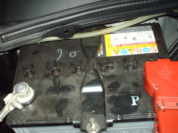

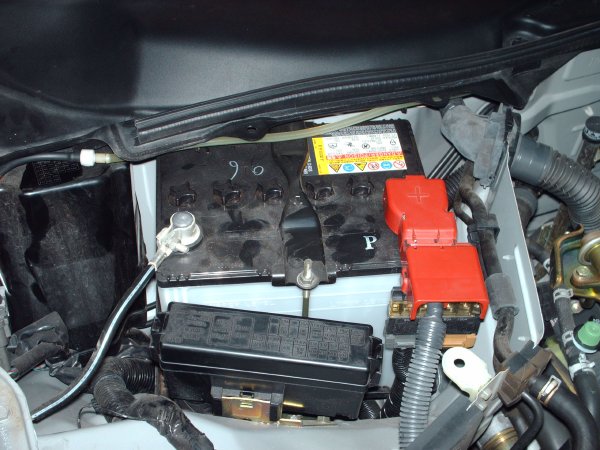

Got a problem :-( where my battery goes in my 350z there is no way of getting a battxery as large as the 2400 in there my stock battery measures 9x6.5x7.5(LxWxH) and its so close to everything that i wouldnt be able to get the large bettery in.So now im in search of a new battery that i can fit in there and keep up with my system.

one problem, a monster may not fit under the hood... i think in my situation it wont, and the 1400 will be too small. so i want to make a fiberglass holster that also holds my fuses and stuff. It should be pretty cool.

see what i mean.

you might be able to fit (3) 600s in there. total of 2550A . or just go back to a 1400 for crank and 2400 in the back. ay man, nobody said this hobby was heap OR cooperative.

look at the extra room to the left of your batt. there is room for a 1400

Dimensions: 9" x 5.3" x 8.1" is the size of a 1400 and my factory battery is 9x6.5x7.5 so i could fit the 1400 but then i will need an extra batt in the rear wich what i wanna get away from especially one that weighs 80lbs. i dont need my car sitting funny from all the weight outback the sub is heavey enough as it is. the 15" BTL. Back to batcaps i can fit the 2000 up front easily and the 800 batcaps are only 14lbs each so i can do 2 of those in the rear.
