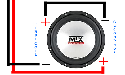

Bronze Member Username: Motomattic3Post Number: 87 Registered: Oct-06 | go here http://mobile.jlaudio.com/support_pages.php?page_id=161 this is series which is= you connect the positive on second coil and the negetive on the first coil then you take a seperate wire and connect the positive coil on one side and connect it to the negative coil on the other side like in the picture below(that will power two dual 4ohms at a 4ohm load) And do this set up for Dual 4ohms at a 1ohm load(parallel) ![]() |
