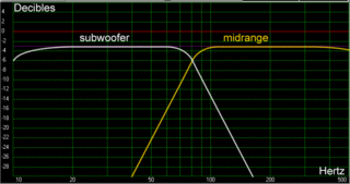

Crossover slopes are the rate at which the crossover starts to cut sound from your speakers per octave.

Think of two shallow hills facing each other (this is representative of say a 6-12 dB slope). If one person were on one hill and one person on the other, then they could each walk down their respective slope and cross each other's path.
However, if these were two very steep mountains (like a 24 to 30 dB slope), these two would not be able to cross each others path. Substitute frequencies of sounds for the people and you basically have the concept of xo slopes.
More detail here:
http://www.caraudio.com/forum/showpost.php?p=770660&postcount=9
http://www.caraudio.com/forum/showpost.php?p=776665&postcount=10
