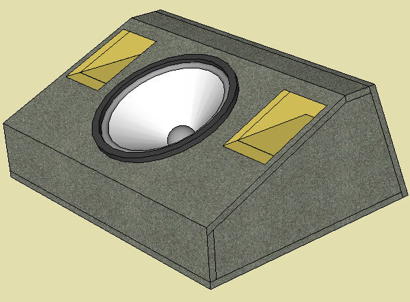

Silver Member Username: Phil_salisburyPost Number: 119 Registered: Sep-06 | I believe this is the enclosure Mr Kebo is referring to: ![]() |
Gold Member Username: TjmutlowPost Number: 3174 Registered: Sep-05 | One big prob, looks like the sub is touching, and that is a no, no, also does the car have a mach system in it? that changes everything. |
Silver Member Username: Phil_salisburyPost Number: 120 Registered: Sep-06 | Ty, Give me some credit would ya!!! The design detail is to scale and that sub is not where near coming into contact with any surface of the enclosure. I contacted Scott @ Fi Audio and got every dimensional detail of the subwoofer that Mr Kebo was going to use for this enclosure design. |
Silver Member Username: Phil_salisburyPost Number: 121 Registered: Sep-06 | Why do ya think I did a side thru view detail, to show the subwoofer clearance from the bottom of the enclosure. |

Gold Member Username: TjmutlowPost Number: 3175 Registered: Sep-05 | Phil sent this over to a box manufacture and this was the response.. That's a very nice set of drawings but it's not going to work. The enclosure will be tuned so high it will sound like a set of 6x9's. The best set up for this vehicle is a single 15" downfire and sealed. ----- Original Message ----- From: "ty mutlow" <tjmutlow@hotmail.com> To: <jclaridy@audioenhancers.com> Sent: Friday, November 10, 2006 10:13 AM Subject: Re: 98 mustang box check this out From: "James Claridy" <jclaridy@audioenhancers.com> To: "ty mutlow" <tjmutlow@hotmail.com> Subject: Re: 98 mustang box Date: Fri, 10 Nov 2006 10:08:10 -0600 This can be done but the Mustang cannot have the Mach460 Sound System. The enclosure will have to be sealed as well. The maximum internal air space is 1.9-2.0 ft3. It will also work better in a downfire set-up. This will give you a ported effect and create a deeper bass load. I have done a system like this before and it worked great. ----- Original Message ----- From: "ty mutlow" <tjmutlow@hotmail.com> To: <jclaridy@audioenhancers.com> Sent: Friday, November 10, 2006 6:21 AM Subject: 98 mustang box here are the specs for this sub 15" can you get a box to go into this mustang(prob sliding from seats) |

Gold Member Username: Tdeaton1021Near Tampa, Florida USA Post Number: 3203 Registered: Sep-04 | question phil: Couldn't you make the port run from the flat area on the front to the back? maybe that will satisfy ty... |
Bronze Member Username: Goodie_goopMidland, Texas U.S. Post Number: 20 Registered: Oct-06 | yes it does have the mach sound system but it is NOT a convertable...so are u saying i cant use this kind of subwoofer/enclosure because of the mach system?? why is that? and that is a pretty nice looking enclosure...would it sound good tho? im goin twords the Fi Q15 so would it be better to get a sealed box? because i want it to sound good but still have people lookin cus they hear it poundin |
Gold Member Username: Tdeaton1021Near Tampa, Florida USA Post Number: 3206 Registered: Sep-04 | Oh, the box isnt even for ty. my bad lol. then ty doesnt have to be satisfied. goodie- a sealed 15Q will still pound but a ported enclosure will give you roughly a 3db increase. |
Silver Member Username: Phil_salisburyPost Number: 127 Registered: Sep-06 | Goodie, I'm not telling you one way or the other, it's seems the so called " experts of car audio " think they have and know all the answers. As for what Ty relayed as to: "That's a very nice set of drawings but it's not going to work. The enclosure will be tuned so high it will sound like a set of 6x9's. The best set up for this vehicle is a single 15" downfire and sealed. " How the he!! would they know what the enclosure would sound like, let alone what the design specifics actual are, they don't know, they don't have a fr!ggin clue other than basing their assumptions on a drawing. Trevor, as to your question, YES, I could easily just move the ports down to the lower front vertical flat: ![]() |

Gold Member Username: TjmutlowPost Number: 3177 Registered: Sep-05 | i never claimed to know all about box building, but just by the specs from the sub manufacturer, that box does not seem right, that is why i got an oppinion from some one that does this for a living and the company has been in business for 20 yrs and has contracts with many companies, like memphis and alpine Q15 DUAL 1 | DUAL 2 Fs: 25.9 Hz | 24.9 Hz Re: 0.7 Ohms/coil | 1.4 Ohms/coil Qms: 5.64 | 5.72 Qes: .54 | .54 Qts: .49 | .49 Mms: 257g | 279g Cms: 0.15mm/N | 0.15mm/N Sd: 810cm^2 | 810cm^2 Vas: 135 l | 135 l Spl: 88.2dB 1W/1m | 87.7dB 1W/1m Bl: 10.4 N/A | 15.1 N/A Xmax: 27mm Rms: 1000W Sealed box: 2-2.6 cuft Ported box: 2.8-4 cuft @ 28-33Hz Sub OD: 15.625" Cut ID: 14.125" Mounting depth: 8.500" Displacement: 0.19cuft |
Silver Member Username: Phil_salisburyPost Number: 128 Registered: Sep-06 | Ty, Look man, I don't want to draw this out into some protracted " they said, who said " mickey mouse argument. I also didn't say " you Claimed " anything, however, your passing along comments, statements and opinions of a third party you brought into the subject. I know what all the spec's are in terms of " enclosure parameter design " because when i first heard about Fi Audio, I contacted Scott and got the skinny from him as to " recommended enclosure spec's " for all of Fi's subwoofers. And, just to be clear on that subject matter, Fi's subwoofer's fall in line with the OLD RE Line 2004 - 2005 Recommended Enclosure Spec's with the noted exceptions that Fi can change up certain build aspects ( magnets ). Last, it has been stated many times by myself and many others that no one, regardless of prior experiences can be absolutely 100% dead on about any enclosure design performance and bass response because there too d@mn many other factor's involved with an install. Given, yeah, sure, someone spends enough time, energy and money to monkey around with a specific vehicle and test, re-test and re-test some more to find the right combination, I won't deny that, but, for the most part, people wan to enjoy car audio, not be bored to death by all the little mickey mouse aspect of it. The competitors in car audio are the rocket scientists because their try to eek out every db they can to WIN. Everyone else just wants there bass they way they want it and there's no rocket science involved to design a decent/good bass massage. |
Bronze Member Username: Goodie_goopMidland, Texas U.S. Post Number: 21 Registered: Oct-06 | Phil- u seem to know a lot about building boxes...would that box u posted pictures of meet the requirements that Ty listed with the ported box sized tuned to 28-33hz? also how much would a box like that cost from you? |
Silver Member Username: Phil_salisburyPost Number: 129 Registered: Sep-06 | Goodie, That design would work for you given the net for it is 3.0 cu.ft., the only thing I would have to do is redesign the enclosure because the ports for that are tuned at 35hz. Keep in mind as to what Mr. Kebo said that the enclosure would have to be installed from the inside, so their height and width restrictions that may or may not be an issue for you installing the enclosure per the final designed size. The enclosure pictured has the overall dims of 34" w x 14" h x 26 1/4" d, these are the numbers you have to concern yourself with in order to fit it thru the opening from inside the cabin into the trunk area. So, let's work out the spec's and details first before we get into what it will cost. Drop my an e-mail: woodlawn.cabinetry@verizon.net with that info so i keep keep track of all the info you provide. |
