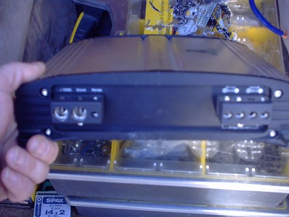

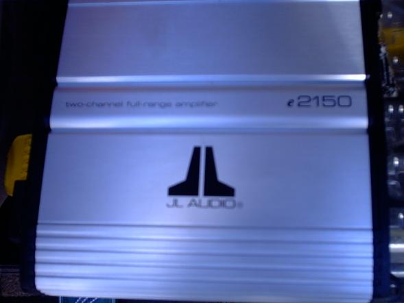

Gold Member Username: Van_manBoston South, MA Post Number: 1076 Registered: Mar-06 | I making a box soon for a JL12W6. JL suggests a box 26.25 W x 14 T x 13 D with port 1.5 x 12.5 x 29 that other site give this after plugging in all the numbers 26.25 wide x 14 tall x 19.25 deep. tuned to 26.45hz with 2.35 cf. So who do I trust? Also 26.45 hz seems a little low too, I was going to go higher ~ 35-38 or so, but i am not sure what to do now. Lastly, I have know idea what the JL spec box is tuned to. Should I just make all three and see which sounds better? or does anyone else have a better idea? Thanks. BTW, my new addition to the van of slam. ![]() |
