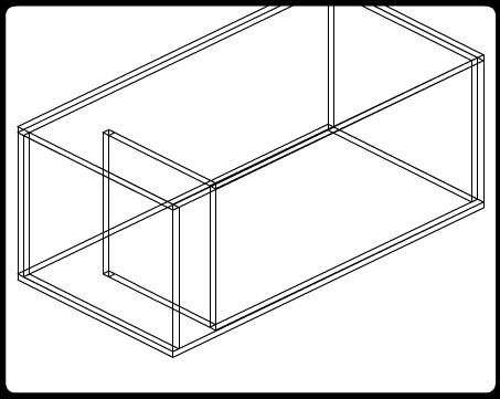

I just had a custom enclosure built for my two RE SX12's. It was supposed to be tuned to 35hz with a 4.75" wide port, but the dumb*ss guy that built my box messed it up even though I gave him all the sizes of 3/4" mdf that needed to be cut out. Instead of a 4.75" wide port he made it 4" wide, which made my box tuned to 32hz instead of 35hz. Below is a pic of my enclosure.
What can I do to the box to tune it back up to 35hz? Can I cut a couple inches off that port piece? Instead of taking out the whole port piece and moving it over 3/4".

cut the length of the port down.. give us exact dimensions and we can tell you how long the port needs to be

15.5" H --- 40" W --- 20" D
Port Width: 4.0"
Port 1 Length: 13.75" x 14"
Are there anymore specs you need?
