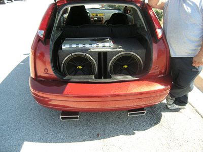

Gold Member Username: FrkkevinLake Worth, Texas US Post Number: 1346 Registered: Nov-05 | what size car do you consider small? Heres two in the back of a two door stratus.. [url=http://rides.webshots.com/photo/2704906080081357071NOxkDT][img=http://thumb11.webshots.net/t/53/653/9/6/8/2704906080081357071NOxkDT_th.jpg][/url] Focus hatch.. I've also seen two audiopipe 15s in the trunk of a Saturn.. thats a fairly small car.. guess more midsize but it was a two door as well. Same setup as the stratus.. subs/port firing into cabin |
Gold Member Username: FrkkevinLake Worth, Texas US Post Number: 1347 Registered: Nov-05 | sorry about the link lol.. but anyway that setup does 152s ![]() |
