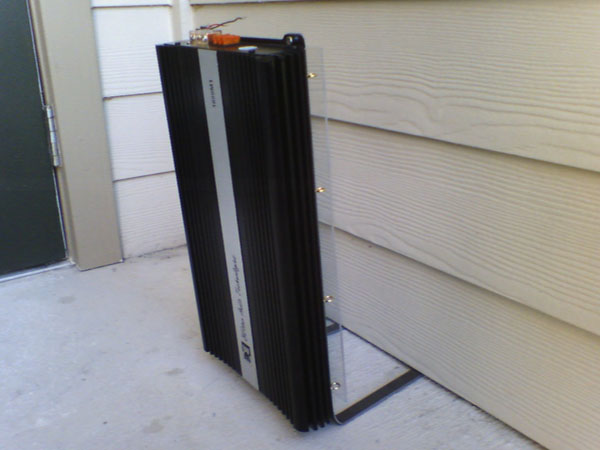

Silver Member Username: FrkkevinLake Worth, Texas US Post Number: 903 Registered: Nov-05 | Ok... Those photos are with my box pushed forward (through the back seat opening) to show what 19inches of box depth would do. When the box is made wider it will not fit through the trunk opening anymore so right there I lose around 5 inches. But anyway, the purpose of making the new box shallower is to allow better view of the amp. I don't want to half them' over-lapping'. Eventually my system will be 'clean' so I'm trying to avoice future problems. I know the interchanagable port would be a problem. So what if instead I made one end of the box tuned to 30hz being a built in port. I could plug it and use an interchangable port on the side. Yes I'd lose the volume of the wood itself for the port tuned to 30hz but I would not be that much. But how would that plugged port effect the box? Would it trap the air or cause more 'back-pressure' acting like a car muffler with baffles? Just curious cuz that was my only option besides making the box bigger. Well that or I could use Aeros but I don't feel like spending %40 bucks on port unless you want to make me some ![]() |
Silver Member Username: FrkkevinLake Worth, Texas US Post Number: 914 Registered: Nov-05 | the amp is going to be inset more but that an idea.. I did start the ![]() |
Silver Member Username: FrkkevinLake Worth, Texas US Post Number: 915 Registered: Nov-05 | the amp is going to be inset more but that an idea.. I did start the rack for it.. |
