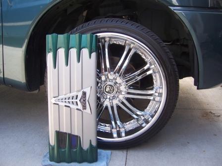

Silver Member Username: Johnny619San Diego, CA Post Number: 183 Registered: Dec-05 | I got a Kicker sx 900.2 that i am thinking or selling for the right price, it is in great condition but the end cap were painted to match my truck ![]() |
Gold Member Username: TjmutlowPost Number: 2829 Registered: Sep-05 | that 900.2 will not work with dual 2 ohm subs.... |
