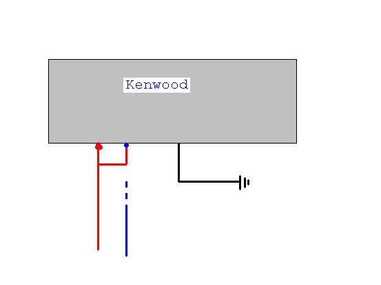

Silver Member Username: Kaos13Phoenix, AZ Post Number: 168 Registered: Oct-04 | hey andrew pass a lil wire from the remote on the amp to the power 12volt to the amp it should turn on also what fuses do you have the little cylinder ones?AGU or something like that? you cant realy tell when those blow i had like two of them that looked fine but when i put em in they dint work when and bought new ones and all is good ![]() |
Bronze Member Username: Andrew571Post Number: 57 Registered: Oct-05 | i dont get what ur saying about the little wire, go from my remote input on my amp, to my power input on my amp??????????? anyways the fuses on the amp are not the cylinder ones, they r the ones that look like car fuses, they are 30 amps each, and both look fine |
Silver Member Username: Van_manBoston South, MA Post Number: 951 Registered: Mar-06 | Jump a wire from the amps power 12 volt feed, to the remote input on the amp. So that the power wire feeds bothe the amp + and the rem. This will tell you if its the amp or remote wire. Do you have a way to tell if 12 volts is present on the power feed wire? Common problem on the Kenwoods is power supply issues. ![]() |

Bronze Member Username: Andrew571Stillwater/Edmond, Oklahoma USA Post Number: 59 Registered: Oct-05 | wow that's weird, i went out there and did the wire 12volt to remote test, and the amp turned on, so i was like YEAH! so i just recut my remote and put the fresh cut into the input and now everything works fine... thanks marc and david <3 :P |
