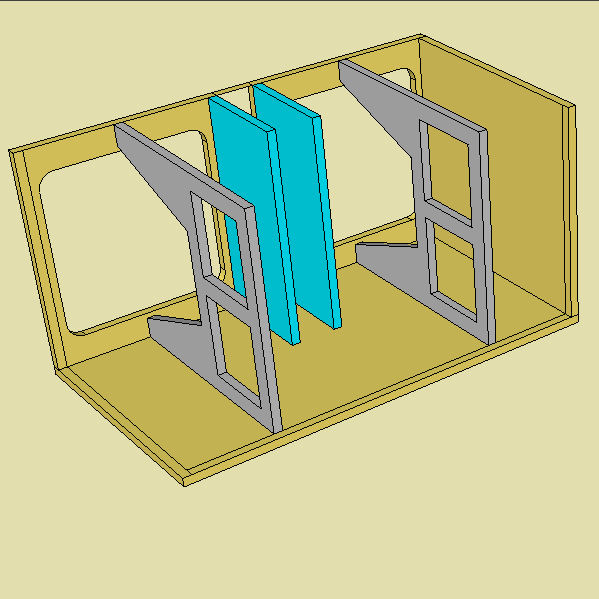

Easy way to solve the bracing issue is to change the design of the enclosure around by moving the port from one side to the center of the enclosure.
Then, instead of a full brace as I showed you, you do a half bracket brace.
By moving the port to the center, instead of one port one as noted on the parts list, you cut two of them.
The ports wall act a brace for the front baffle, the half bracket bracket brace still spans front to back, but at the top & bottom of the brace braces the front baffle center of the subwoofer.

No, you still need the bracing because the width of the slot port walls aren't going to di<k for bracing except at the front baffle.
The half bracket bracing will be more than enough that doubling the front would be required.

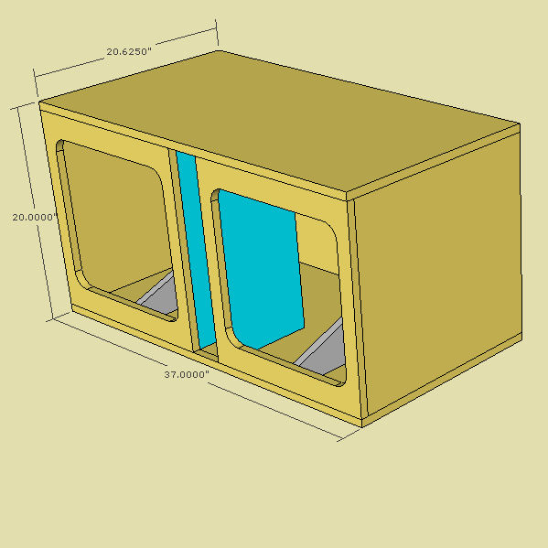

Alright now that i have 37"W 21.75"D 20"H i made a box but help me out on it still see if its ok and make corrections thanks phil :-) http://i11.photobucket.com/albums/a176/xxYupxx/Box2.jpg

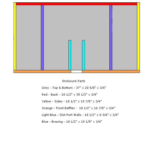

Username: Phil_salisbury
Post Number: 50
Spl,
I'm not going to work on this tonite.
I get at first thing in the morning after I had my two cups and not before.
As for your revised design, yes, your math is correct - .6250" spacing.
However, if you wish to maintain the original spec's you calculated before, you either have to drop down the height or the depth.
Personally, drop the depth, don't mess with the height. If you don't adjust it, your tuning changes because you increased volume.
Post Number: 54
Spl,
Here's the final design plan and details for the enclosure.
