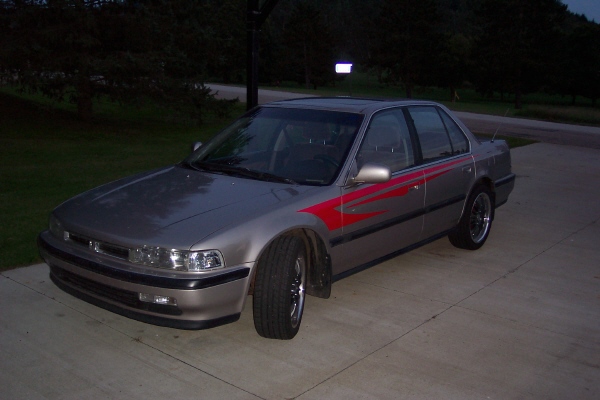

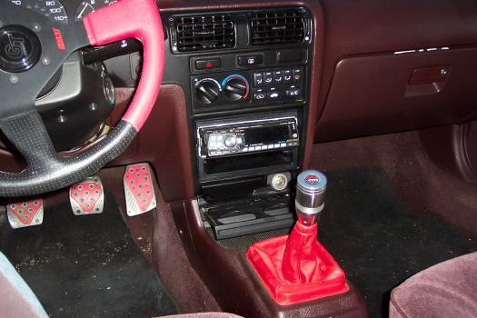

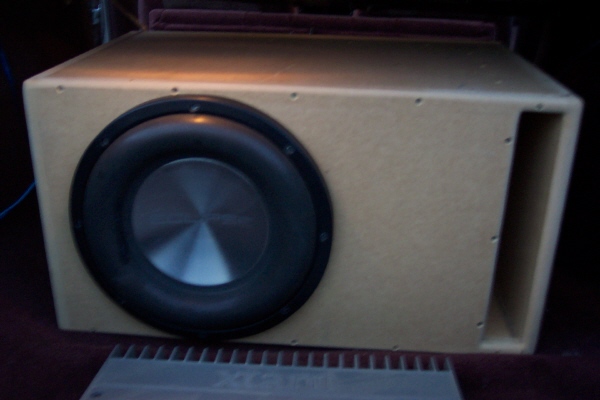

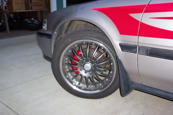

Gold Member Username: Alias747MN Post Number: 1311 Registered: Apr-05 | Finally got the pics I have been promising for like a week. Enjoy! BTW, any constructrive criticism is welcome! :P Pics of my car. I painted the brake calipers and drums, I think it looks pretty good. Got the graphic on the side custom made by a friend of mine that works at a sign shop, I might be adding more to it soon. I might be adding a spoiler soon also! My Eclipse 12" Ti and Xtant A6001T. The amp puts out about 750 wrms, perfect for the Ti. OFCOURSE I cannnot forget the brand new custom box I just got! 1.65 cuft NET, tuned to 36 hz, built like a rock! Curtesy of Marshall White. Love it buddy! Backside of the box and my JBL 2 channel amp that powers the rear JL coaxs. The amp is rated for 75x2 @ 4 ohms. Seems to give the JL's plenty of power and it sounds great! Kinda messy I know, but you can't even see it from the front, but I'll spruce it up sometime. The cockpit! The HU is an Alpine CDA-9813. I think that Glasswolf had this exact same HU, so it's gotta be good! lol Plus it is like 3-4 years old, back when Alpine was makign their REALLY good quality units. I am happy with it. Plus I got it for only 150 bucks! Nightime! Pretty bad pic but you can barely see the red glow from under the seats, the shifter knob is pretty bright though. That's all. Hope you guys like it, I am happy with it! I guess thats all that counts! |
Gold Member Username: RedlinerWilmington, Ma Post Number: 2469 Registered: Jun-05 | hey u know that the ti can take 1500 rms right they rate them per coil so its 2 coils 1500 watts alot of people dont know that though. But i bet it still sounds nice and great install i love the box lol |
Silver Member Username: FrkkevinLake Worth, Texas US Post Number: 718 Registered: Nov-05 | eeekk Marshall.. box is rough :P .. nah box is great and so is the setup .. all ya need now isaac is some carpet |
Gold Member Username: Alias747MN Post Number: 1312 Registered: Apr-05 | Thanks charlie and Kevin. Actually charlie they are rated 750 wmrs. They do not rate per coil. However they can take much more than 750 wrms. I am going to be getting a Xtant x1001 soon hopefully and give that Ti a good 1000 watts. MMM... can't wait. Kevin: Actually for the box not being caprted it sis very nice. Marshall routered the edges so they are round and smooth. It looks real nice in person. My camera kinda sucks so all the pics really aren't giving justice to anything! lol ![]() |

Silver Member Username: Naledge503Portland, Oregon U.S. Post Number: 229 Registered: Jun-06 | I like it. Are you gonna lower your car? |
Gold Member Username: BestmankindLos Angeles, CA USA Post Number: 5553 Registered: Oct-05 | its about time you posted some pics isaac. nice setup. that thing looks like it just screams good sq. |

Gold Member Username: Alias747MN Post Number: 1313 Registered: Apr-05 | Thanks Jesse, I want to lower it but it costs so much money to! I need to buy front stage components and a 4 channel amp before I drop cash for that. Unless anyone knows a cheap way to lower a car? |
Gold Member Username: Alias747MN Post Number: 1314 Registered: Apr-05 | Thanks Chad, my goal was SQL all the way! Charlie, I e-mailed Eclipse and they told me directly that they are reted 750 wmrs and not per coil. They did not even recommend giving it more than 1000 wrms. |

Silver Member Username: AdddisorderWest palm, Florida Post Number: 810 Registered: Jan-06 | nice set up i like those rims thats pretty much what i want to get. how much did you pick them up for? |
Gold Member Username: SouthernrebelMonroe, Louisiana USA Post Number: 3339 Registered: Mar-04 | Good to see the box made it to ya in one piece. I packed w/ foam all around it, but was still alil scared FedEx would mess it up someway. I gorilla glued the h3ll out of that box! Predrilled and counter sunk all the screws too. My router bit was really dull though, so i had to go back and hand-sand all the burns off the edges. Anyways...looks good man. Try hiding those wires alil though, that would make it look 110% better. How does it sound? I hardly ever get to hear Ti's. |

Gold Member Username: Alias747MN Post Number: 1315 Registered: Apr-05 | Mat I got them for 650 shipped brand new. That included the mounted tires and balancing. I thought it was a pretty good deal. Hey Marshall! What wires are you talking about the ones going out from the amp or the ones behind the box? As for how it sounds, AWESOME. I'll admit, I haven't heard a ton of systems, or atleast a lot of good ones, because most systems around here sound like ass! But still, it sounds really good and gets really loud too. I still want to give it more power though, hopefully I will be getting the X1001 soon! |

Silver Member Username: Camaro823British Colu... Canada Post Number: 725 Registered: Jun-05 | Nice Isaac, like the setup and the graphic on the car is sweet. |

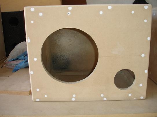

Gold Member Username: RovinTrinidad & T... Post Number: 9089 Registered: Jul-05 | looks very decent man my 2c - dont put a spoiler unless u also intend 2 do a full flare kit around coz that will look so offkey hey i got something in common with marshall in that I too also use a round over router bit on the edges - makes it look more pro & neater here is a pic of 1 i hav in my pc now this box has ALL its internal edges braced with 3/4 x 1.5" mdf pieces . Those white spots r where the filler covers the screw heads so when carpet goes over it ,its smooth & u wont see like dimples .... |

Gold Member Username: Alias747MN Post Number: 1317 Registered: Apr-05 | Looks like a nice box Rovin. Do you build a lot fo boxes? Or just for your own subs? Thanks for the 2c, but what is a "full flair kit"? Is that your way of saying a body kit? I always knew you Trini's were a little goofy... Haha, JK. I have a friend that is Trinidadian and he is REALLY goofy, he cracks me up! |
Gold Member Username: RovinTrinidad & T... Post Number: 9091 Registered: Jul-05 | im starting 2 do a few boxes 4 ppl here in T&T https://www.ecoustics.com/electronics/forum/car-audio/266392.html 'ground effects or flair kit' well i guess u all will call it a 'body-kit' then but here we would call a bodykit like if u change both front/rear fenders , add ground effects , change fr/rear bumpers & add a rear wing spoiler ...... ![]() |

Gold Member Username: Basshead86Google is your Friend, FL Post Number: 5983 Registered: Aug-05 | looks good man that box is AWESOME. |

Gold Member Username: SouthernrebelMonroe, Louisiana USA Post Number: 3340 Registered: Mar-04 | ctmike, (and anyone else that might want a box) Hit me w/ an email at marshall_white2004@yahoo.com tell me what's your vehicle, sub(s), and power. I'll get back you ya w/ a quote. My prices are very reasonable! Isaac W., I was talking about the wires around the JBL amp. Looks great all in all! If you dont mind, I'm gonna rob one of your pics to put up on my sounddomain page to i can start showing off more of my boxes. I sold a ported box for 2 cvr12's and started on another box this weekend. |
